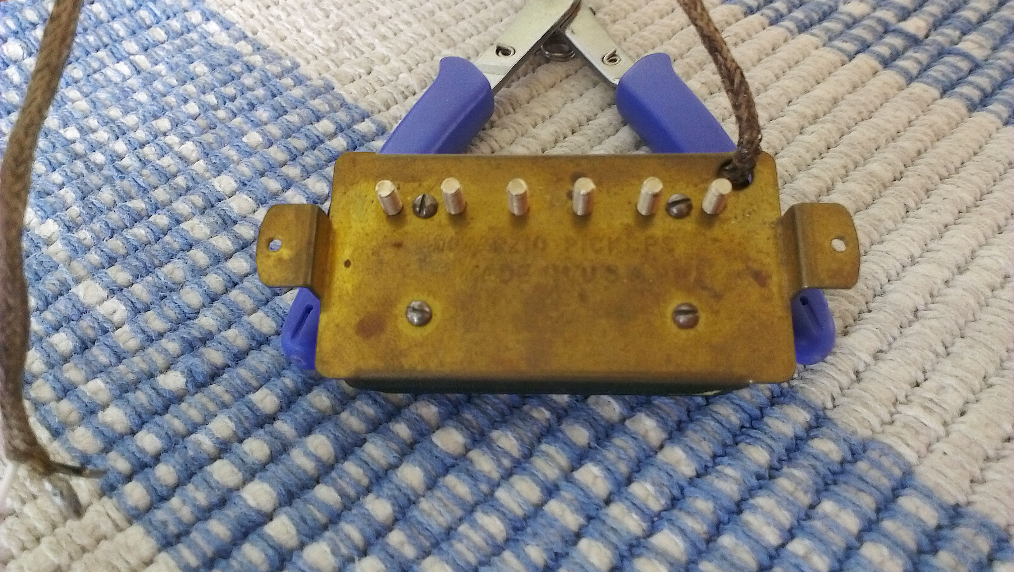

JochenP Posted November 19, 2017 Posted November 19, 2017 which is the correct bottom plate for a early 80´s DiMarzio PAF? rectangular or triangular "ears" ?
JochenP Posted November 20, 2017 Author Posted November 20, 2017 11 hours ago, Jakeboy said: Both. It depends upon the year. It should be correct for my 1981 special !? Thanks!
Joe G Posted November 20, 2017 Posted November 20, 2017 On 11/19/2017 at 8:34 AM, JochenP said: A DiMarzio PAF made in '81 should have triangle feet.
Hamer Dave Posted December 4, 2017 Posted December 4, 2017 I’ve seen both in about 1980. Triangular thereafter. Thus, ‘squared’ prior. Yes, 1981 would be ‘triangular’.
serial Posted December 17, 2017 Posted December 17, 2017 1979 seems to be the transition year.. Braided to plastic-sheathed leads and square feet to triangular.. The slug coil poles changed between 1982/83 from beveled to flat.
