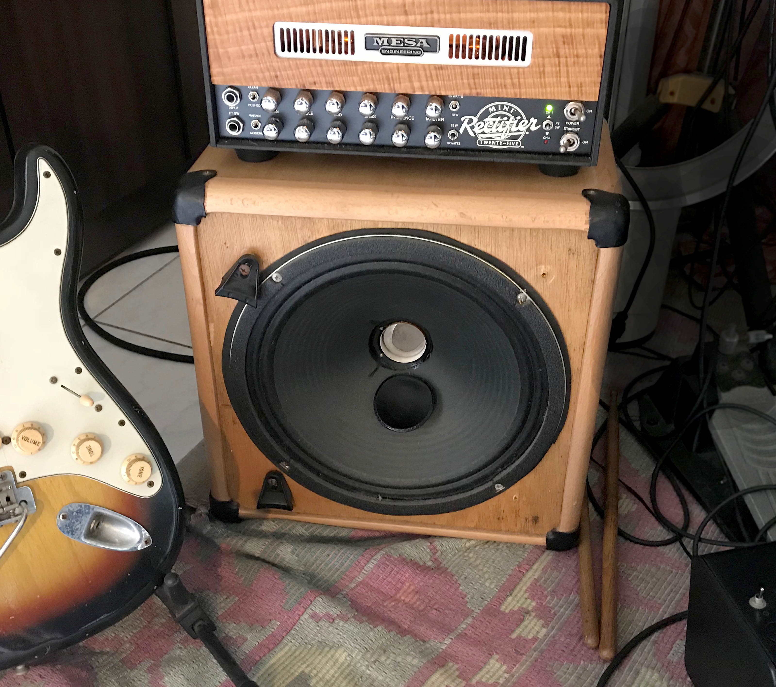

jaberwock Posted December 12, 2017 Posted December 12, 2017 The dust cap on my Celestion driver has fallen off, any body know what kind of glue I should use to reattach it ? Thanks Jaberwock
Uncle Thor's Hamer Posted December 12, 2017 Posted December 12, 2017 If nobody has a knowledgeable answer, I recall reading on a speaker manufacturer's FAQ about this. It was under the topic of replacing or repairing the voice coil. Perhaps a search about the voice coil would find your answer. Sorry I can't recall what the site was or what glue they recommended.
marcnorth Posted December 12, 2017 Posted December 12, 2017 https://www.parts-express.com/parts-express-speaker-repair-glue-1-oz-bottle--340-076 I'm sure any glue made for paper or felt would work.
unfun75 Posted December 13, 2017 Posted December 13, 2017 That stuff looks like Elmer’s but it stays tacky way longer. I got some when I ordered surrounds. Good stuff.
jaberwock Posted December 13, 2017 Author Posted December 13, 2017 Thanks, I'll give it a go with rubber cement, I'm guessing it's not as critical as gluing the surround. The adhesive Celestion uses looks almost like a black silicon. Regards Jaberwock
hamerhead Posted December 13, 2017 Posted December 13, 2017 Yeah but that one rubber cement sounds waaaay better than those other ones.
