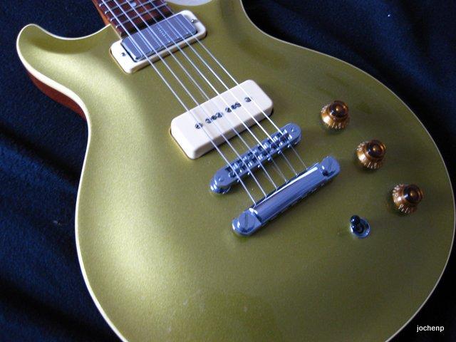

seeker Posted February 13, 2019 Posted February 13, 2019 Am looking at converting my 06 Studio Goldtop to run minihums; currently has P90s. Have found the mounting brackets on Stew Mac, but am unsure about which pickup mounting rings to get. https://www.stewmac.com/SiteSearch/?search=mini humbucker mounting Have had to sand down rings before (McNaught neck angle is non-standard), but would like to minimize that if possible. BTW the MHs are a 70s gibson in neck, with a 63ish Silvertone (P-19?) in the bridge. Got em in a swap with my bro.

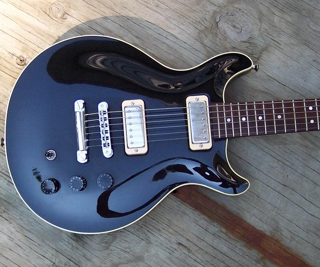

Jakeboy Posted February 14, 2019 Posted February 14, 2019 I put Firebird minis in my Artist, which was designed for full size buckers. I found black plastic mounting rings on eBay. They are also out there in chrome. Here is a pic:

Jakeboy Posted February 14, 2019 Posted February 14, 2019 Ahhh....I missed the P90s part. When I tried the birds in my P90s Firenza I bought mounting rings from Guitarfetish that worked. They were tight in the cavity (!) But they worked.

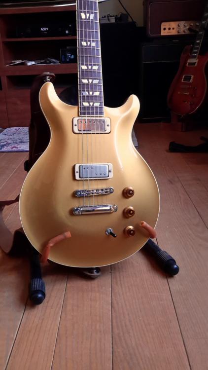

seeker Posted March 19, 2019 Author Posted March 19, 2019 What I have found is that the original LP Deluxe rings appear to be 85mmin diameter, but the current crop of replacement rings are almost all 87mm. Stewmac, Allparts, even GFS. The only exception are Wilkinson rings, but the only source I found is a guy in the UK on ebay. Ended up cutting a notch out of the sidewall to cut out and replace the stripped bolt. Then sanded down that side to fit in the cavity. Result:
