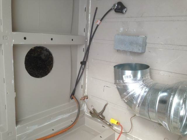

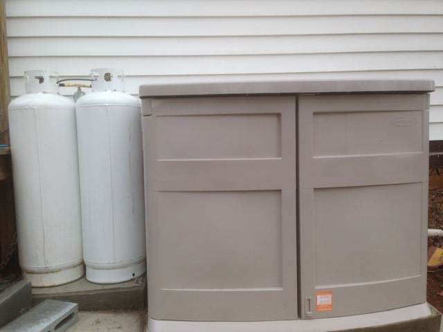

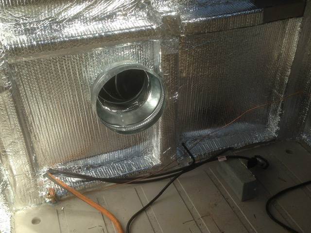

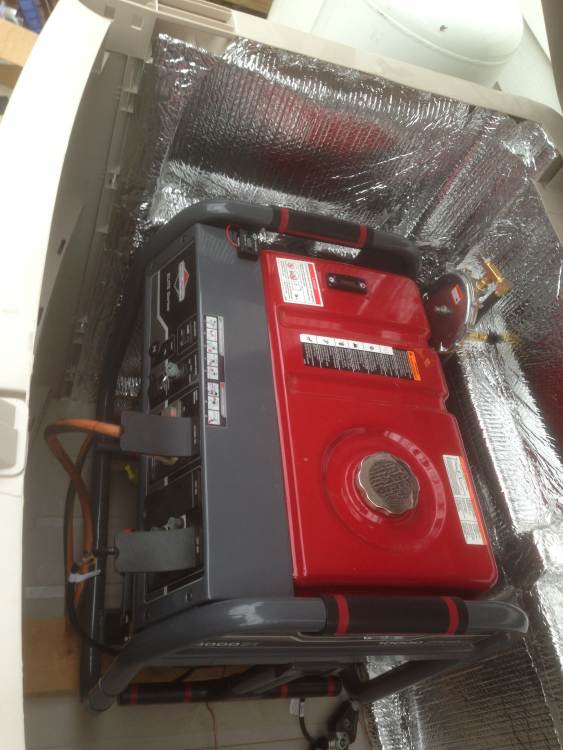

I made an 8kW (10kW surge) setup for my house (1150 ft2). It has a LP conversion, and runs everything I really need except for a clothes dryer and central HVAC. It does run the mini split unit in my shop tho... It gives me lights, hot water, cold beer, microwave, a stove eye, fridge / freezer, and hot coffee. I was recently out of power for two days, and it used roughly half of two 100lb LP tanks (keep in mind an outage a couple years ago that lasted 5 or 6 hours, and periodic fireups / 20 min runtimes to exercise the gen is also included in that.)
As stated by others, add up the power requirements of everything you intend to use at one time. Keep in mind that simply adding certain loads won't account for startup requirements which are different from running requirements... Although a 10kW portable won't start the compressor on a typical central HVAC unit (it does run the blower), it will run a small mini split or a window unit.
My project came about because of past outages which lasted anywhere from 1 to 5 days, where I had to drag out a portable gen, haphazardly set it up in the elements while trying to protect it, etc. It sucks. What I have is MUCH better than that now, It is back-fed thru 2 separate breakers in two panels, and a Main to isolate from the service. I'll post pics in a bit.
Disclaimer: If starting from scratch, I'd go with a standby set which can be had for $4-5k w/ATS, but if you already have a decent gen this is not a bad way to go. Remember to ground!
