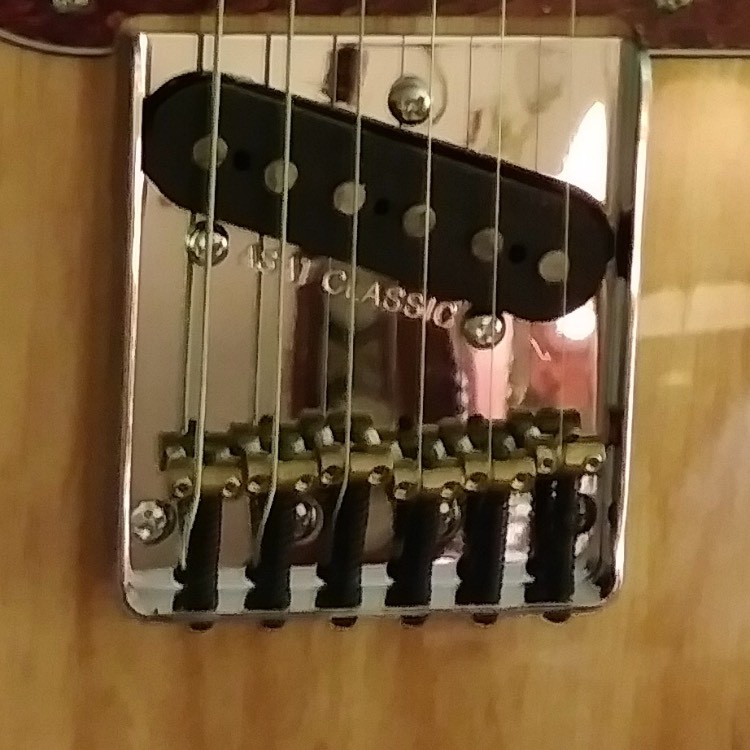

Posting a pic that was the original reason for the question. While the action is not low, it is certainly not high and the saddle height adjustment screws are near the top of their travel. If the neck angle increased slightly, I could lower the saddles to get the the 12th or 17th fret height I am now. The string could come off the fret at a larger angle and have more space to vibrate.

since you have the bridge saddles at max, you could experiment with sandpaper or wood veneer shims to see if they get near your desire of a setup since its a bolt on neck.
just loosen and capo the strings at first fret and have your way with it :)
Would be simple and non-destructive. Even if I take it to the shop in the end, will have learned more about setups and how to find issues. With the good deal I got, the cost for professional work is even more worth it. The guitar really sounds great.

If you do have to shim, what Murkat said about sandpaper.  It was necessary on my Frankenstrat when I built it.  A folded over bit of 600 grit sandpaper did the trick.  The paper is already compressed and the grit gives is a little grab on the wood to keep things from shifting.
I unbolted the neck Sunday to shim. Found thick finish at all 4 corners and one with a piece of tape. Removed the excess finish carefully with an X-acto knife and put it back together since it was getting late. About the same as before. If I adjust the high E saddle at 5/64 or above it is sort of OK.
