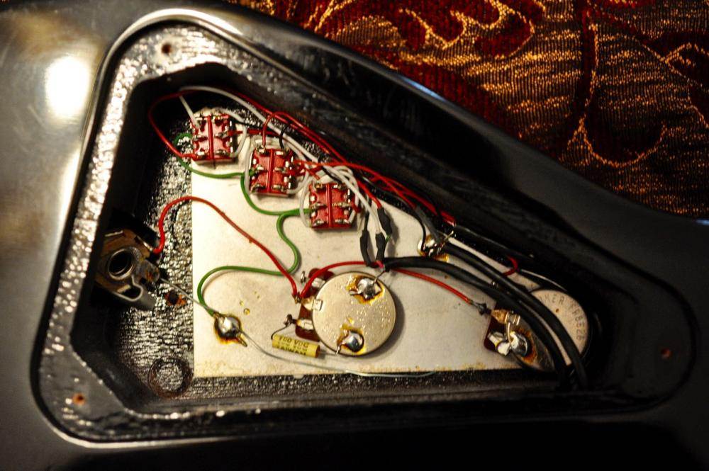

Hbom Posted August 5, 2022 Posted August 5, 2022 Title says it all. Asking for a friend. Thanks. Also does anyone know who's picture this is? I have it labeled as a Chaparral Custom w/EMGS belonging to Punkavenger but he said not his.
Dave Scepter Posted August 5, 2022 Posted August 5, 2022 I would wrap the battery with thin foam and stick it in this area
tomteriffic Posted August 5, 2022 Posted August 5, 2022 Agreed on the positioning. Hopefully the thin foam will work, but I had a Chap5 bass that discharged very quickly anyway. I wound up wrapping the battery completely, with several layers of electrical tape to keep it from shorting. A PITA to be sure, but better than it conking out halfway through a show.
Dave Scepter Posted August 5, 2022 Posted August 5, 2022 6 minutes ago, tomteriffic said: Hopefully the thin foam will work, but I had a Chap5 bass that discharged very quickly anyway. I wound up wrapping the battery completely, with several layers of electrical tape to keep it from shorting. Yes thin foam "to keep from bouncing around inside" wrapped with electrical tape... really not a pita as changing battery is not that often... I've had a 9v battery inside my Jackson Soloist for years now... still waiting for it to die 🤣
Jimbilly Posted August 6, 2022 Posted August 6, 2022 On 8/5/2022 at 12:29 PM, Dave Scepter said: Yes thin foam "to keep from bouncing around inside" wrapped with electrical tape... really not a pita as changing battery is not that often... I've had a 9v battery inside my Jackson Soloist for years now... still waiting for it to die 🤣 Don't wait too long, it might leak and cause corrosion!
murkat Posted August 22, 2022 Posted August 22, 2022 sturdy packing sponge, cut to size where you want in cavity, cut out a battery to size withing the packing sponge. easy peasy.
Hamerica Posted August 23, 2022 Posted August 23, 2022 On 8/22/2022 at 8:32 AM, murkat said: sturdy packing sponge, cut to size where you want in cavity, cut out a battery to size withing the packing sponge. easy peasy. Oh, great idea!
