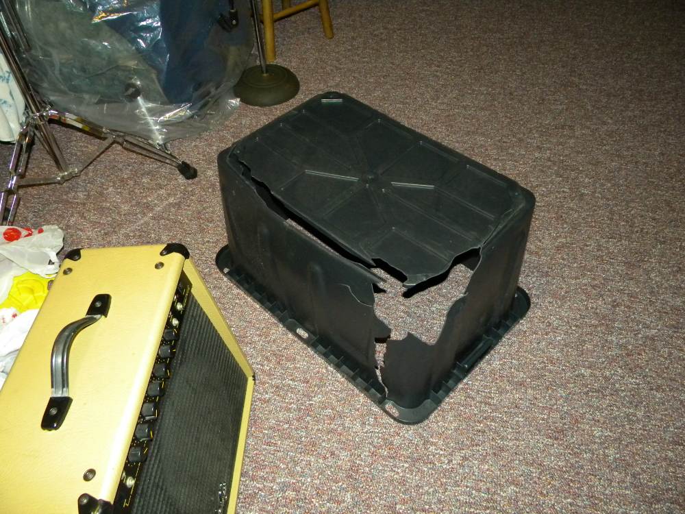

hamerhead Posted November 15, 2022 Author Posted November 15, 2022 A shout out to Travis who came thru with a great little amp! UPS tried their best to make splinters out of it, but Shawn's packing secret saved the day. Thanks, Travis! Shawn - you really need to buy something from me.....
bubs_42 Posted November 15, 2022 Posted November 15, 2022 Hum, I wonder if the Tempature had something to do with it. I shipped two just like it and they arrived safe and sound. Whatcha got for sale? LOL
hamerhead Posted November 16, 2022 Author Posted November 16, 2022 Yeah, I don't know if it hit 30° today, so that might be a thing.
Travis Posted November 16, 2022 Posted November 16, 2022 Glad it made it. Note to self, mummify the tote in duct tape on the outside and add more “filler” on the inside…

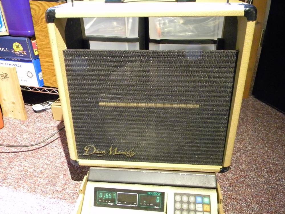

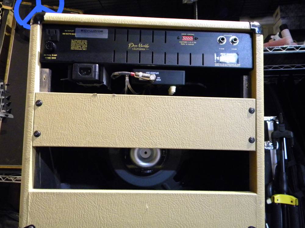

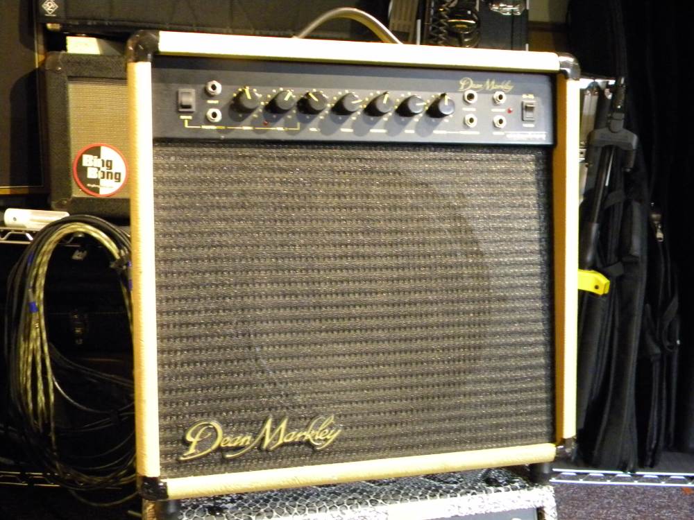

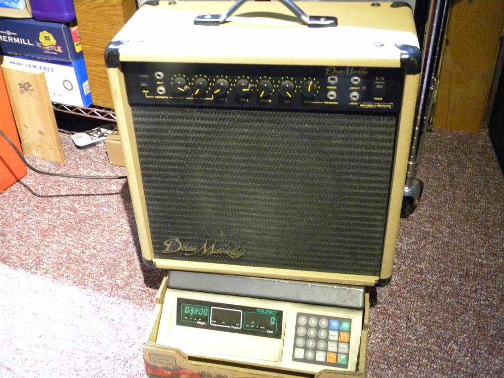

hamerhead Posted November 19, 2022 Author Posted November 19, 2022 So this turned into less of a project than I thought. The idea was to gut Travis's Dean Markley: ...and rebuild it as a lightweight rehearsal amp, something around 20-ish pounds. Well after removing the head and the speaker, this stout little fucker still came in at 16.5 pounds. Even with the planned neo speaker and tiny amp I was already in trouble: So I took the easy route: instead of re-inventing the wheel and making an new aluminum faceplate, I re-used the chassis (to cut some weight I removed the reverb tank and transformer), then installed a new input jack (in the original spot) to bypass everything and go straight to a Quilter Microblock (45W) and on to the Eminence Lil Texas speaker. So from the outside it looks stock, but absolutely rips. What I had in mind was a bit different, but this turned into quite the little sleeper. It still weighs in at about 26 pounds (but amp pounds are like guitar pounds - every one matters). And it was done in a day instead of a week (or more....). It sounds pretty great and I would definitely gig it. Gotta love the Quilter stuff.

geoff_hartwell Posted November 23, 2022 Posted November 23, 2022 Neat! Is the quilter bolted in place, you set the knobs where you like em, and use as a clean pedal platform?
hamerhead Posted November 23, 2022 Author Posted November 23, 2022 Basically, yes. I can still get a hand in there if I need to, and it would take about 10 seconds to remove the amp (the way it's wired) and use it for some other really great idea (). The Quilter takes pedals extremely well. The gain is set so there's just a hint of grit, EQ about flat, and volume about 6-7. It's very much like a tube amp in that too much volume and/or too much gain will turn it to mush, while not enough volume leaves it pretty nutless. It definitely has a sweet spot, which was a big surprise.
