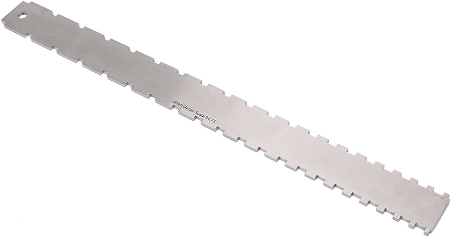

The absolute GOAT and MVP of bench tools for set-ups is a notched straight edge. You ideally want to measure and set relief off the fingerboard, not the frets. Why? Because frets wear away over time, particularly in the case of guitars that are decades old like many of our Hamers. If you are measuring and setting relief off fretted strings using worn frets as your gauge, what you think is ideal relief could actually be dead flat due to worn, eroded frets.
Notched straight edges typically have a 24.75 side and a 25.5 side. The 24.75 side works on PRS and anything else with 25.0. The one I use cost almost a hundred bucks from StewMac. But you can get a high quality clone on eBay made of steel for a fourth of that.
There are notched straight edges for basses too, with 34 on one side and 35 on the other.
Yup that's exactly the tool I used.  I bought it from stewmac years ago.  The fretboard is perfectly straight -before I made it straight it was curved and they still buzzed.
