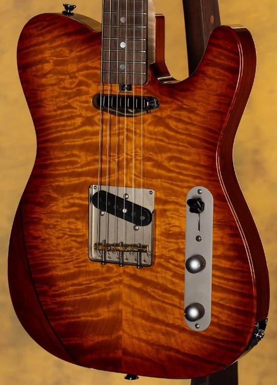

This guitar is nearby (Willcutt) so I went today to give it a try. The G string was sitaring at the nut, they filled and filed it on the spot. Net for me, the fingerboard radius is too flat. The “fast” C profile was fine. Otherwise, I probably would have brought it home. Larrivee now offers two thicker neck types, also with the compound radius. The guitar is gorgeous, great materials like the one piece lightweight ash body with quilted top, flamed maple neck. Pickups sounded great. Looked unplayed except some tarnish on the brass compensated saddles and a few very small dings on the back at the bottom. The bridge is a matte finish Callaham stainless steel. This was one of the prototypes of the 2020 series. Asking price is $1499.99 with new ones listing for $2799.99, seems like a good deal if you like the neck. https://willcuttguitars.com/products/larrivee-baker-t-lar-baker-t-used-134337
Anyone played a Baker-T Classic or Pro? Any thoughts? The specs look great, depending on what neck profile you like. There is a used one local (2020 model) at a good price. Light weight one piece ash with quilted maple overlay.
