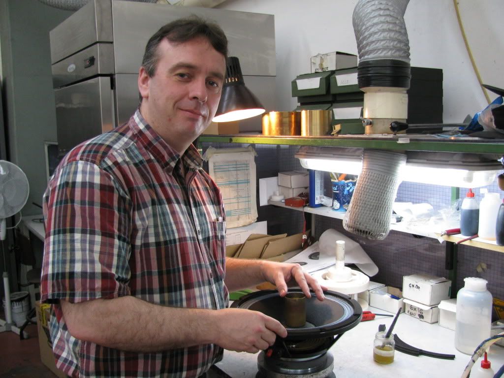

A couple years back, I was the US service manager for RCF and received training on re-coning at the factory in Italy. I don't have a ton of experience on it, but I did it successfully a couple of times. I have a bunch of pictures detailing the process, and could help you out over the phone or Skype to aid in your decision. Glad to help out - lemme know.
