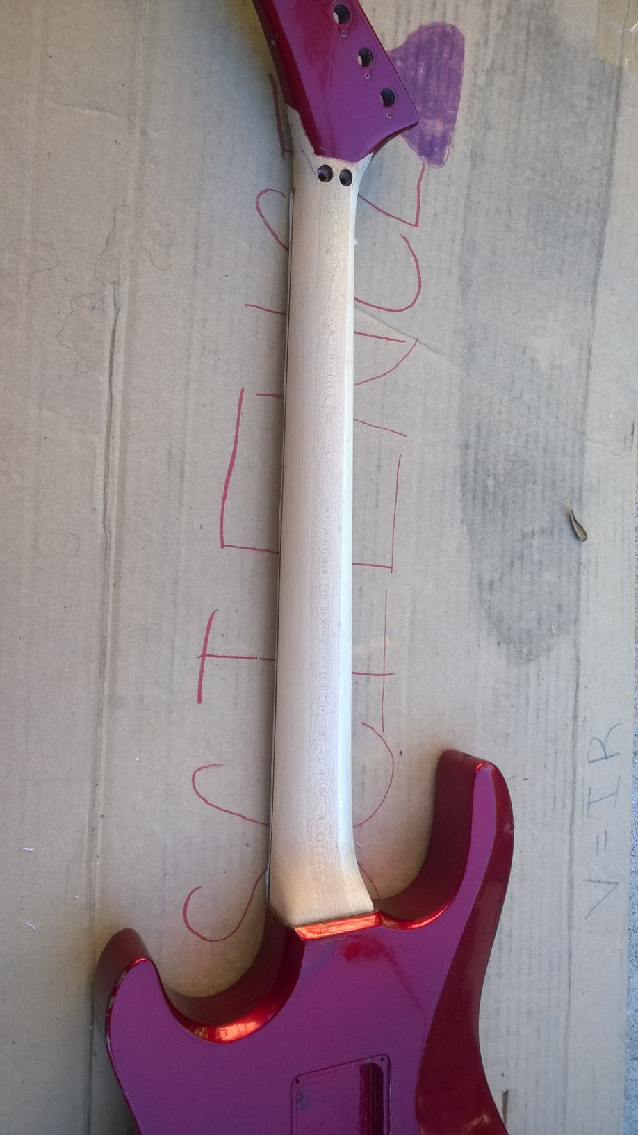

Hello everyone. I'm in the process of stripping down a Chaparral custom and I was wondering if it safe to use paint stripper on a guitar? I'm concerned that it will cause issues with the wood. Also how do you clean the residue of the paint stripper? I stripped the neck and I noticed that even after sanding my hand gets irritated when i touch it. I also wiped it down multiple times thanks!

On 3/27/2016 at 4:44 PM, Steve Haynie said:
It looks like your Chaparral has had a headstock repair.
Yes, it was stated when I made the purchase. I had some stainless frets put on it.
