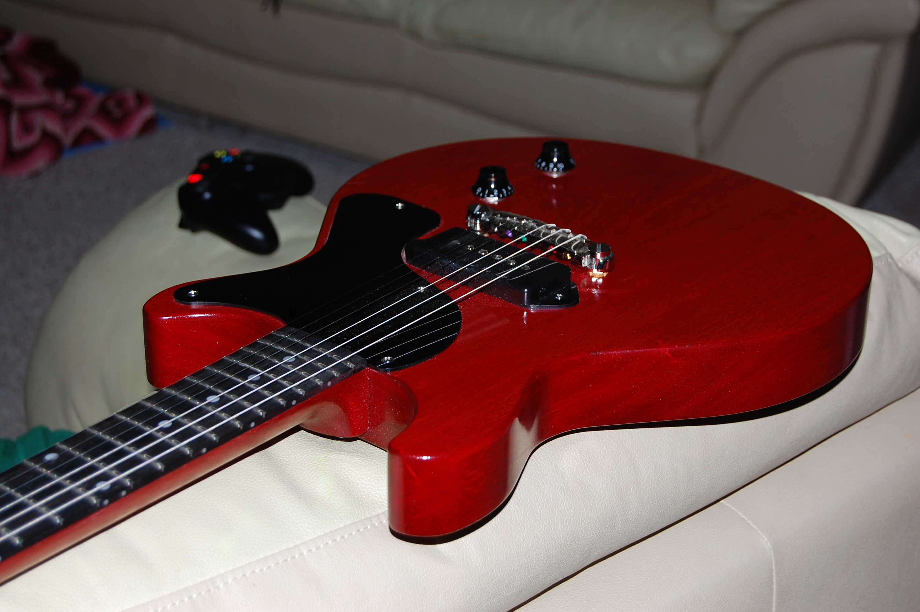

gtone Posted November 20, 2016 Posted November 20, 2016 On October 28, 2016 at 11:33 AM, it's me HHB said: Im thinking of staining the top only and in something more vivid than the back and sides. Pore filled and laquered Headstock black of course, neck unstained and tru oiled. I already have a Faber bridge and some cool open back tuners w small buttons. Its not a restoration at all. Stock 1958s pup pots cap and wiring Late to the party (again!), but here's my DC Jr build in Tru-Oil finish over red aniline dye. The dye was a single coat, mixed with alcohol so the grain wouldn't get raised, applied by cloth. Followed that up with about 10 coats of Tru-Oil. Really cool part was that with the first coat or two of Tru-Oil, you could "move" colour around a bit in case your dye was applied a little heavier/lighter in spots or to make up for variations in the underlying wood coloration. Don't know if this is the colour and/or finish you're gunning for, but thought you might be interested all the same... Good luck!

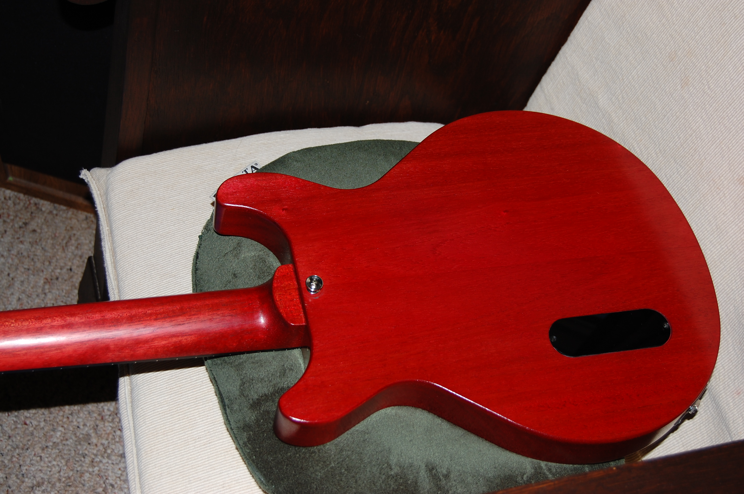

gtone Posted November 20, 2016 Posted November 20, 2016 Another pic which perhaps better represents the true colour as the eye sees it. (In hindsight, the one above appears a little more orange than the guitar really is).
