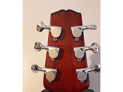

So after having my 79 Sunburst for less than a week, I've found the Grover Bullseye tuners to be sloppy.  There is no real positive feel, and tuning stability is a problem.  Is there a way to service these old tuners and bring them back to some level of feel and accuracy?
I do have a set of Gotoh 510 which will fit with no hassle (I had these on my Artist Korina)
I'm not too fond of Grovers to be honest, and although it would be good to leave them on for originality, I've no qualms in putting the Gotoh 510s on and popping the original Grovers in a draw.
What are your thoughts please?

I removed the old Bullseyes from one of my old Hamer's, Standard or Sunburst, can't remember. But I took them apart completely. There is grease in them, and after like 40 years it's turned to crust in most cases. So what I did was I cleaned everything thoroughly. Then I applied new grease, fishing reel lube if I remember correctly. Then I put everything back together and put the tuners back on the guitar.
Big improvement!!! Much better tuning stability etc.

Well.  Grovers came off and I took them apart and cleaned the worm gear.  There was 38 years of crud in there.  I also cleaned out the tuning gear.  I then re-packed the worm gear with lithium grease, and also added some finer oil to the tuning gear.  Re-assembled and the feel is still a bit hazy, but tuning stability is much better.

Well, despite my earlier post, the Grovers are still hopeless so the Gotoh 510s have gone on.  The Bullseye Grovers are safely tucked away in a draw.  The Gotohs have exactly the same footprint so no indentations or holes.  A straight swap.
