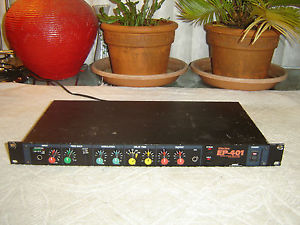

I've owned an Electra EP-401 since the early 80's.  I hadn't used it for a while and when I pulled it out the controls all crackled or cut out when trying to use it.   Is there any thing that might clean up the pots that won't involve taking it apart?
IIRC, I only payed about $100 for it.  Was a lot to me at the time but it definitely isn't something too valuable.

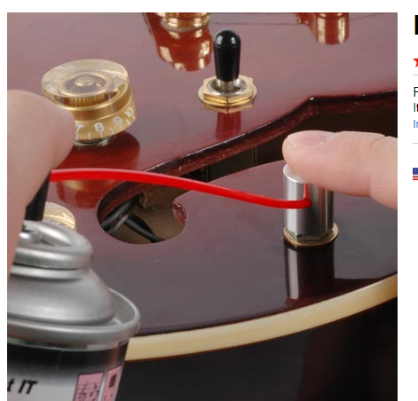

Hi: Can you easily pull the knobs off of the unit, and are the potentiometers standard 'USA guitar' sized? I found a nifty gadget at StewMac that allows you to spray contact cleaner into the pot without dismantling, all you need to do is remove the retaining nut from the pot and screw this gadget on, then insert the spray tube on the contact cleaner into the hole on the side of the gadget and blast away. I've cleaned up dirty pots on a strat without removing the pickguard this way. Good Luck!
https://www.stewmac.com/Luthier_Tools/Tools_by_Job/Tools_for_Maintenance/Pot_Cleaning_Cap.html
