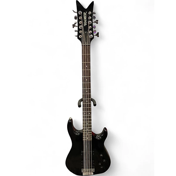

VincentYGB Posted November 7, 2025 Posted November 7, 2025 I just returned this 12er to GC Tucson so it'll be popping back up shortly. Cheap at $599 but the string mount's ferrules are spinning and the piece is pulling up. It's a Korean one, which is basswood, so if you have the skills to install larger ones, the rest of the instrument is in great condition. I have too many other projects to mess with it. 3 Quote

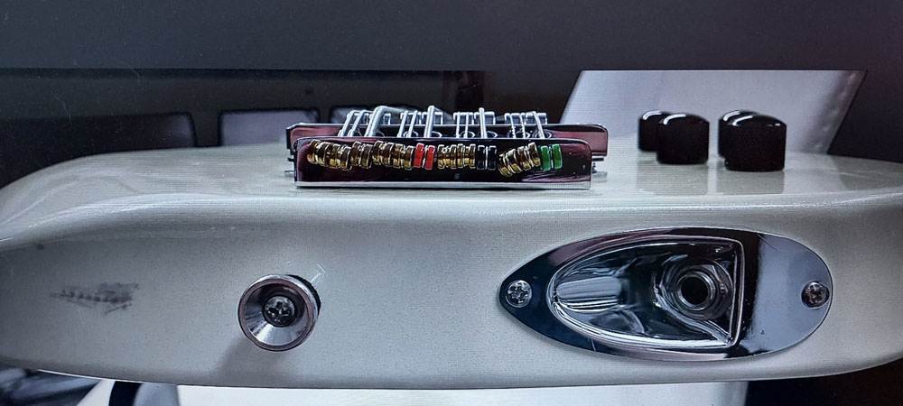

VincentYGB Posted November 8, 2025 Author Posted November 8, 2025 (edited) Should have said tailpiece. Here's a pic from my old CH12. The tailpiece should be flush against the body, although in the pic you can see it's slightly raising on the left. On the black one I returned, the entire tailpiece was lifting almost 1/2" up on a 45 degree angle. The four mounting screws just turned in the ferrules. At least they weren't popping out but the tailpiece was lifting as the bass was tuned to proper pitch. I've had both a CH12 and a B12L in the past. The basswood of the Korean CH12's is fairly soft, unlike the B12L's. Edited November 8, 2025 by VincentYGB info added 4 Quote
