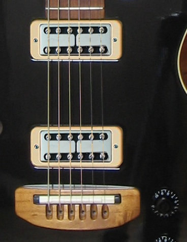

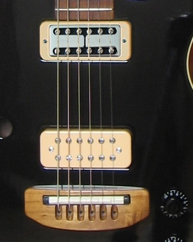

kanegon Posted November 10, 2013 Posted November 10, 2013 Anyone try toaster pups with a Duotone? Never liked the Duncan P90s and a set of Minitron Liverpools wouldn't be a huge investment. Maybe some Gretsch rockabilly mojo lurking in the Duotone semi acoustic DNA. Or hold out for TV Jones.... Here's the fakeup with GFS pups:
django49 Posted November 10, 2013 Posted November 10, 2013 Worth a try. I did an upgrade to a Phat Kat (neck) and Rio BBQ (bridge). I like the combo.I would love to hear your tone review.

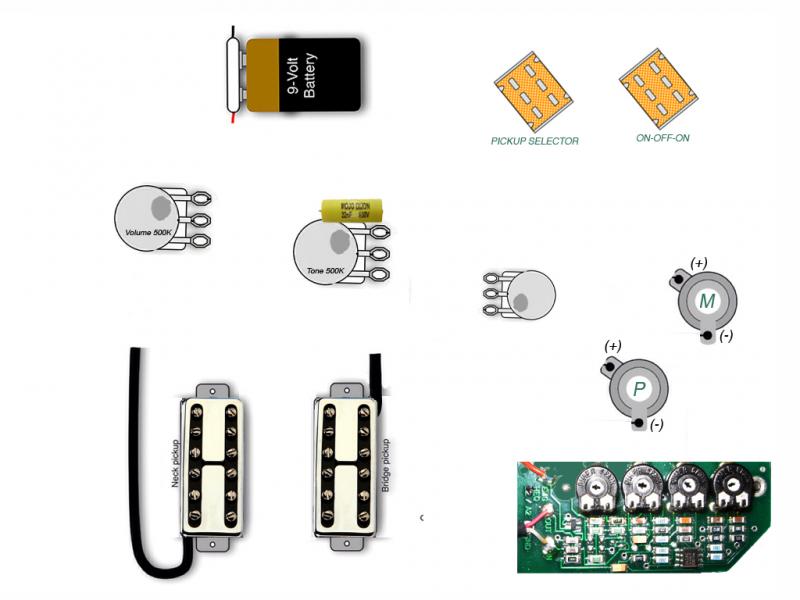

kanegon Posted November 11, 2013 Author Posted November 11, 2013 Well, can't just stop there, since they'll have 4 conductor wires.1. wasn't there a BCR mod that simply mixes the piezo and magnetic pups, eliminating the selector? that would open up the mini-toggle for coil tap/series/parallel duties. can I just connect the wires and balance via the volume knobs?2. a single DPDT in place of the acoustic-electric selector could do the tap/series/parallel thing TOGETHER, but I'd need another switch to tap them separately... I think. Could I use the same switch to tap just one or the other?3. or just give in and replace the pots with push pulls to tap the pickups independently.Any suugestions would be appreciated, haven't a clue about wiring, though going nuts lately rewiring previously mangled projects. Especially if there're any schematics, just don't know if any Hamers were offered with push pull/mini switching options (besides the Duotone).Slowly getting stoked...
sirskelt Posted November 11, 2013 Posted November 11, 2013 I'd bet the piezo with some neck pickup rolled in would be a great tone.+1
veatch Posted November 11, 2013 Posted November 11, 2013 Regarding the extra tap switch - I'm trying to remember if a push pull would fit given the eq board. Maybe on the vol pot?
kanegon Posted November 11, 2013 Author Posted November 11, 2013 Regarding the extra tap switch - I'm trying to remember if a push pull would fit given the eq board. Maybe on the vol pot?Ugh, hadn't thought about that. I'm leaning towards just tapping each of the pickups at a time with a switch in place of the current piezo-magnetic selector. My Martin EM18 has a 3 way mini toggle that does that; tapped neck, all humucker, tapped bridge. Just need to figure out the BCR mod. Guess, I'll drop him a note!

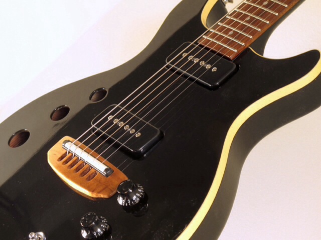

kanegon Posted November 25, 2013 Author Posted November 25, 2013 Well, I chickened out, I wasn't blown away with the Supertron and I like lotsa bass. I got a deal on stock Gibson P90s, which instantly cured the Duncan mud. I ripped the same pups out of my Special and replaced them with Lollars, only to realize that I prefer Gibsons. As far as I can tell! these sound almost identical to me 68 SG Jr. At 8.1k, same for neck and bridge, they're totally old school. Maybe not as jangly, but gobs of great tone all around. Why did Hamer stuff those overwound SDs in the Duo? Let me guess, the humbuckers version probably came stock with JBs in the bridge!
