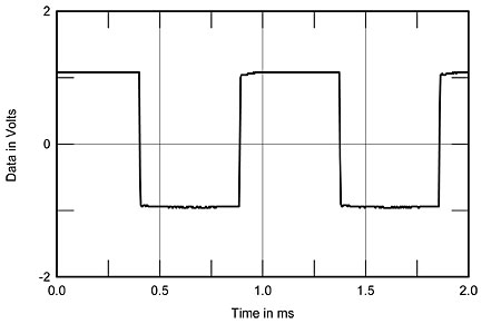

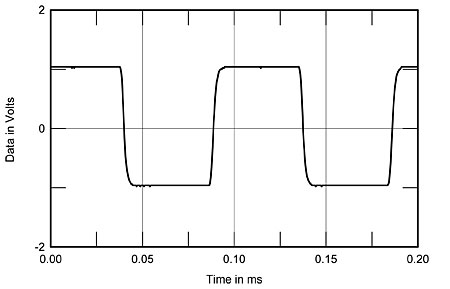

You don't have to hear an 80 Khz test tone to appreciate the musical benefits of a wide bandwidth design. There is a direct relationship between high frequency response and the "speed" of an amplifier--how short the rise time is. Short rise time makes for clean, articulate sound, richer fuller overtones (which define the character of an instrument's sound) and make it easier to hear all the voices and instrument of a recording. No one can he 80 Khz, but just about anybody can hear and appreciate the speed and articulation of an amp that is linear out to 80 Khz and beyond.
This is the measured frequency response curve of the Audionet Max monoblock amplifier. Into an 8-ohm load, it is down only 1dB at 200 Khz!
... and here is the Audionet Max's measured square wave response. The less slop to the vertical sections, the faster the rise time, with its associated benefits:

... and here is the RR2150's square wave response. Note the slower (i.e., less vertical) rise times and the rounding of the corners.
Again, wider bandwidth creates faster rise times, and just about anyone can notice the increase in clarity, detail, pace and rhythm.

Those square waves are impressive. If you like classical music, which is much more dynamic than a lot of rock music, definitely a good thing to have.
