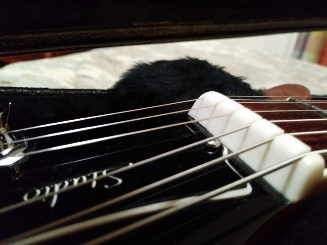

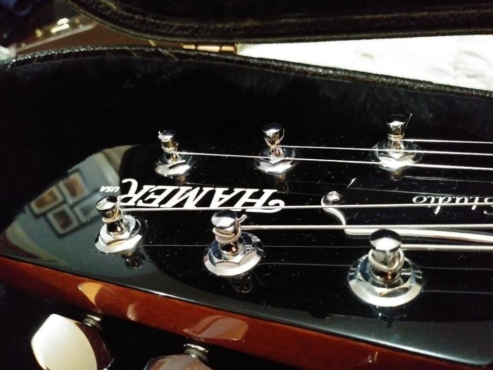

tbonesullivan Posted November 29, 2018 Posted November 29, 2018 What's the break angle over the nut look like? If it's ringing behind the nut that would usually mean that it's way too shallow of a break angle. Do you use standard tuners, or locking tuners?
BoogieMKIIA Posted November 29, 2018 Author Posted November 29, 2018 I will need to get a photo later. No locking tuners. Factory nut and setup so assume break angle would be correct. Wondering in the notch in the nut could be wide. May loosen the string and pull out to see if there is any debris in the slot.

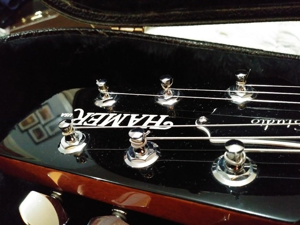

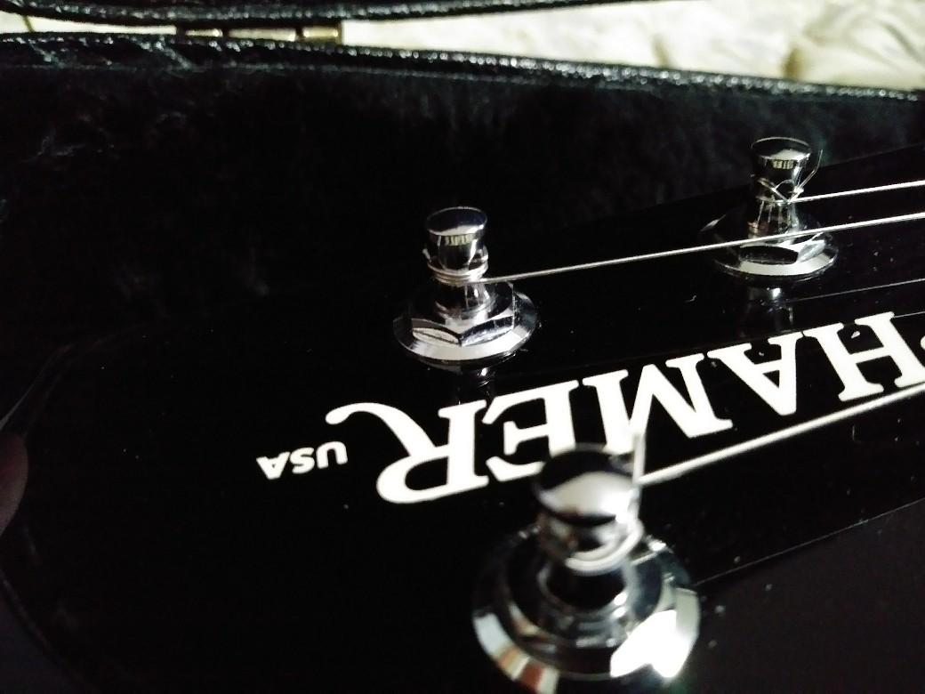

Jeff R Posted November 29, 2018 Posted November 29, 2018 Double-check that all six hex ferrules on the machine heads are tight while you're up there too. Loose one(s) can cause exactly what you describe.
tbonesullivan Posted November 30, 2018 Posted November 30, 2018 8 hours ago, Jeff R said: Double-check that all six hex ferrules on the machine heads are tight while you're up there too. Loose one(s) can cause exactly what you describe. AH! That's right! I find loose ferrules all the time on my guitars... of course after I just changed the strings. Never before.
Jakeboy Posted November 30, 2018 Posted November 30, 2018 If that break angle isn’t steep enough, you will indeed have that issue. I had that on a partscaster Tele I built and a simple string tree on the g & d strings took care of it.

BoogieMKIIA Posted December 2, 2018 Author Posted December 2, 2018 Seems it is the string angle on the back of the nut. Put a new G string on with a few more wraps and the buzzing greatly reduced. I ran a feeler gauge thru the nut slot and did not feel any burrs. The tuner nut was tight. Maybe the nut slot could use a little work, will see with next string change Have had Tonepros bridge and locking studs installed. Waiting on a pair of Gravelin Ultimate PUs. Perhaps I can get $375 at that point.
Thundersteel Posted December 3, 2018 Posted December 3, 2018 The nut slots are too deep. According to Dan Erlewine, "The slots should be only deep enough so 1/3 of the string is above the top of the nut and 2/3 in the nut."
Jeff R Posted December 3, 2018 Posted December 3, 2018 Seems it is the string angle on the back of the nut. Put a new G string on with a few more wraps and the buzzing greatly reduced. I ran a feeler gauge thru the nut slot and did not feel any burrs. Slot is too wide, string is vibrating sideways in the slot. Fill the slot and re-cut the slot with the proper gauge nut slot file. Easier said than done if you haven't done it before, but that's what needs to be done.
