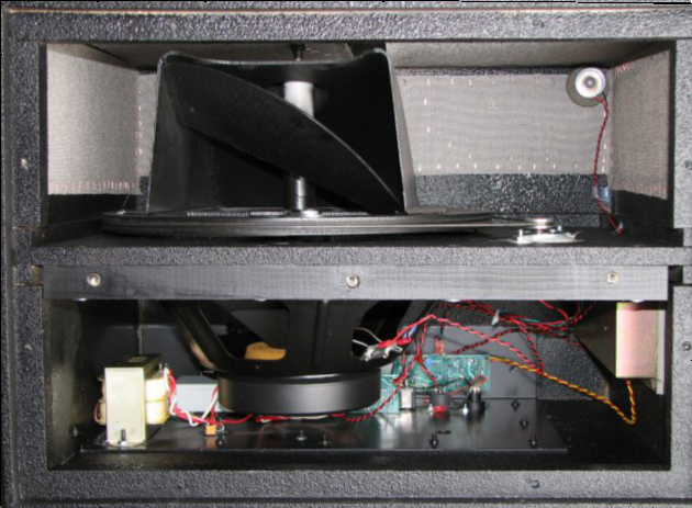

Any idea what is in it stock? Eminence makes some nice speakers, but they are also pretty big frame wise. Make sure you get measurements on the stock speaker to make sure that it'll fit.
Link to comment
Share on other sites
Good point - it has the stock Eminence Legend 12" speaker. There's not a lot of room in there:
