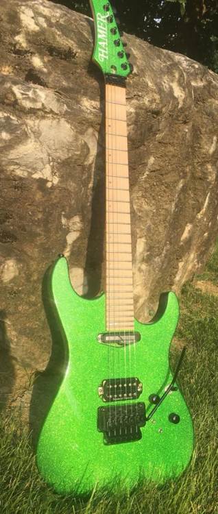

3 hours ago, HAMERMAN said:
Yes - Green Metalflake is great for flying under the radar! 🙂
I concur...
17 hours ago, HAMERMAN said:
That is sweet. I always like the look of matching a headstock, especially in cases like this where it's an in your face color.
Funny thing is, initially I spec-ed it to be bare wood. I love the look of the Charvels with unpainted head stocks and  black tuners, locking nut and logo. Something about the visual contrast. Somewhere along the line, that request got missed. :PThat said, I do like this arrangement but would have liked a black Hamer logo as it would stand out more.
That Hamer came out great, and I've wanted something that color for a long time.
