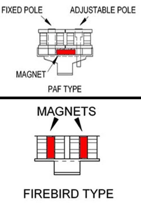

There is a bunch of variation regarding the internal construction of the Mini Humbuckers, particularly the Firebird style vs the style used in the Les Paul Deluxe.
The LP deluxe of course, is just a scaled down PAF design. The Firebird instead has a bar magnet inside the bobbins themselves, and no pole pieces. Then there's the weird stuff that Bill Lawrence did, which involved the "sidewinder" design, which was also used in some basses, and I think based on a Seth Lover design?
INFOS: http://www.heliotricity.com/firebird-pickups.html
I always post this picture when the subject comes up:
