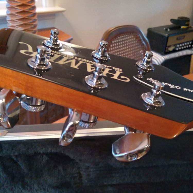

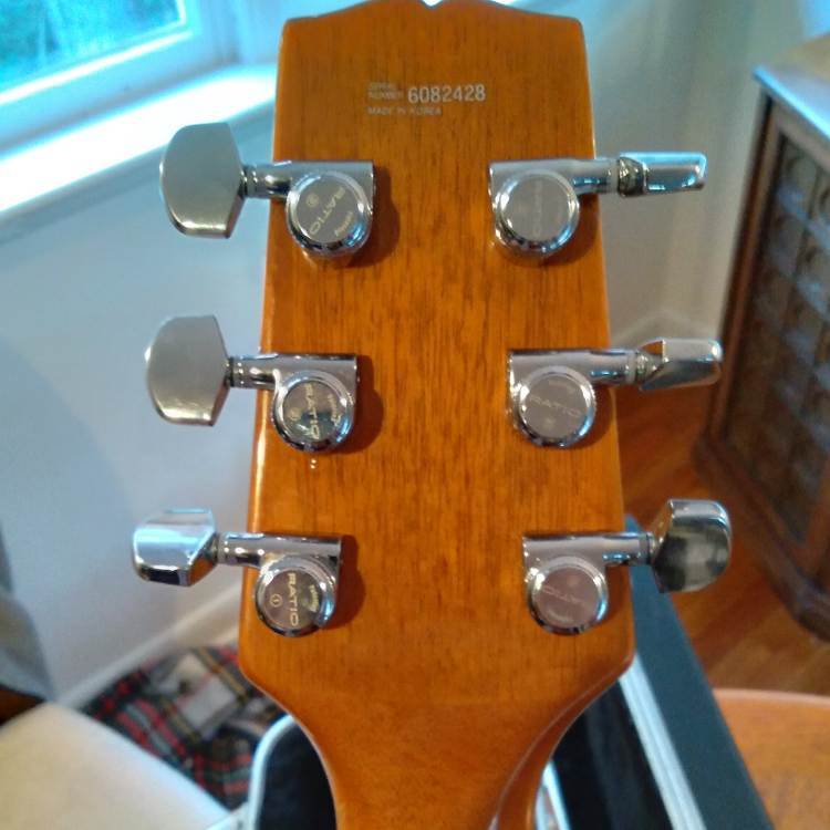

Hey there,
Looking for a direct replacement... MIK Sunburst mid 90's
These appear to be the 2-Pin indexing type tuners with no screw, Dont have the guitar yet, so i can only run off the picture... I'd like to go ahead and order some replacements, why cant I find this type that's 3x3 instead of 6 inline?
Thanks

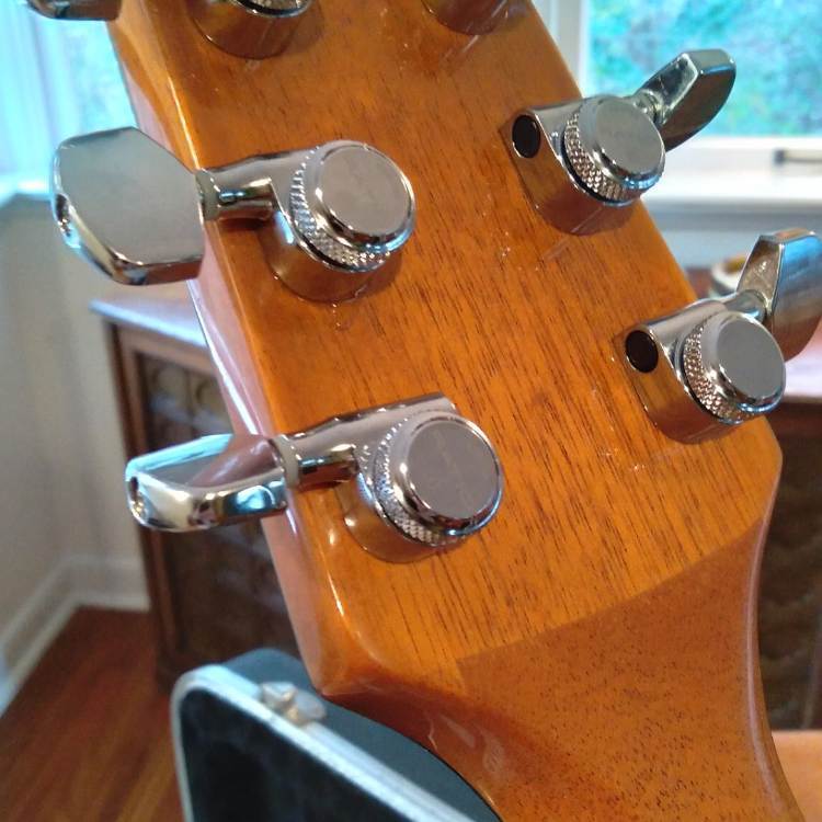

2 pin tuners: I tried to find, dug around, and sadly couldn't come up with much. Sperzel makes a single center pin that's 3x3 and this pin-hole would be hidden once the tuner was installed. As an upgrade option, this is as good as it gets I think because there would be no visible changes to the back of the headstock. My .02 - good luck!
Sperzel makes 'EZ-Mount' pinless tuners. All you have to do is make sure the tuner is straight before tightening. From their site:
"The Sperzel EZ-Mount requires no such drilling for the mounting pin. There are two prongs projecting from the back of the housing that actaully sink into the wood as you tighten the washer and barrel nut onto the headstock. These prongs efoortlessly perform the same task as our standard mounting pin - keeping the tuning key from moving on the headstock - without the added drilling.
EZ-Mount can be ordered for 6 in-line or 3x3 style headstocks. Simply line up the tuning key on the headstock to look straight, then hold in place as you tighten down the washer and barrel nut — it's that easy."

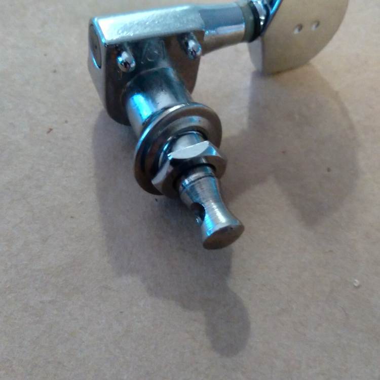

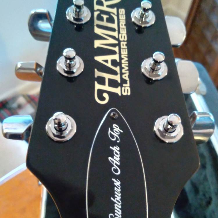

Im back to follow up on this ? and hopefully give some feedback that may be useful to some..
First off, the MIK slammer is great, period.
I took the advice left by a few members here, that ended up being mostly helpful. Their recommendations to not jump to any conclusions and start slapping replacement parts on was sound. I bought the guitar online prior to ever actually even seeing a hamer.. any hamer...in person.. ever.. lol. But the deal was great so I took the chance based on my gut. So glad I did.. I was immediately impressed when I arrived to take it home w me. The wood, the finish.. the overall feel was of a, much, much higher standard than I anticipated. After a short time at home, it quickly became the guitar I was reaching for the most..
Now, as far as the hardware, and tuners specifically..again, I was impressed and happy that I wouldnt have to replace them after all... or so I thought...I'll preface by saying that the quality was 100% acceptable, and as good and even better than most, honestly. I think the issues, in my case, relate back to the over all age and wear on the tuning machines.. Mine do appear to be the originals, no hamer logo, so I might assume early MIK. The fretboard and other clues left me to believe this guitar has been played quite a bit by the previous owner at one time. I was informed by the seller this guitar was part of a large collection that went to estate, so it may have sat for a long period of time as well, not sure... regardless, for tuners nearly 30 yrs hold, they've held up remarkably well. It may be my frequency of playing the guitar, or simply timing..nothing last forever, but after 6 mo, I began to notice frequent tuning, as well as spikey tuning. Some slop in 2 of the gears, jumpiness so to speak.. As much as I hated to, I knew it had to be done..
That led me back to here.. again..

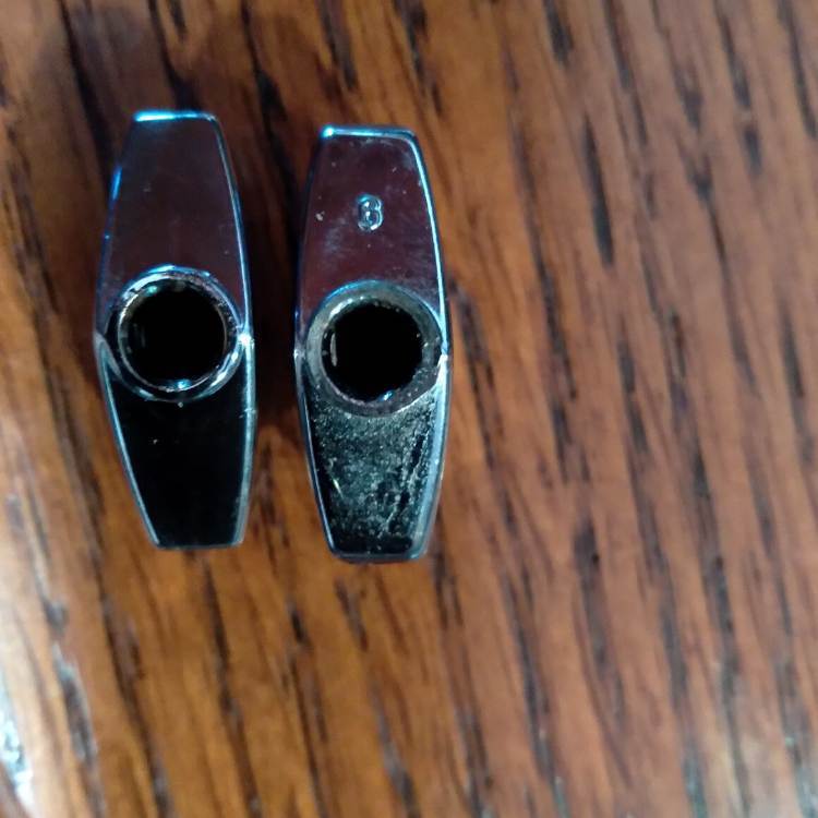

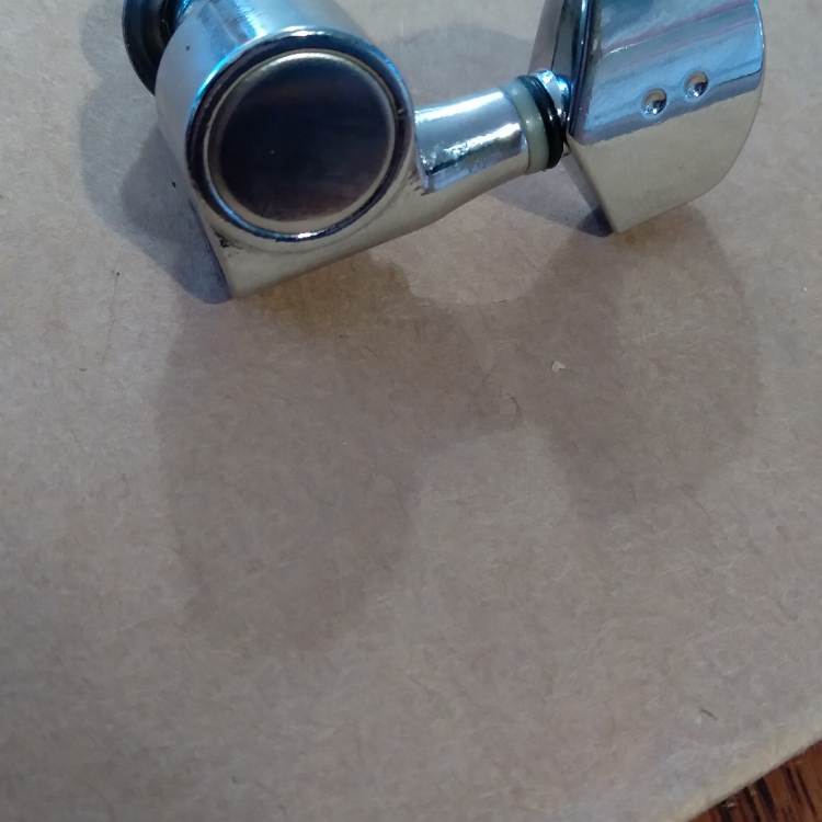

At the advice of hamerhead, I went w the sperzel EZ mount in hopes I would get lucky w the 2 indexing pins matching up, and no drills or additional screws needed. I WAS HIGHLY AGAINST ANY MODIFICATIONS... my only quam being I didnt like the buttons..with the 2 wierd dimples (why? Sperzel). Nonetheless, a stable guitar and tuning was more important, so if they worked, id live w the not-so-nice buttons...

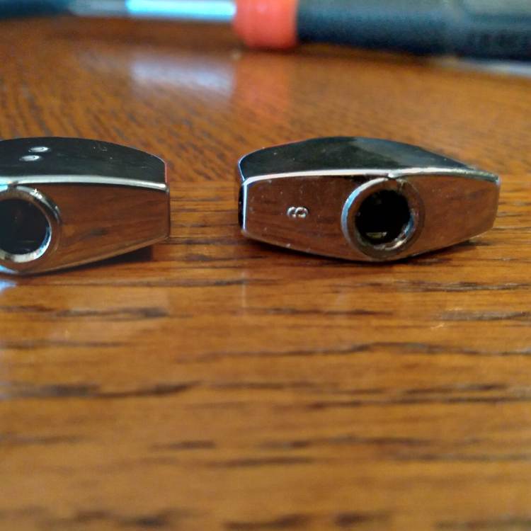

THEY WORKED! Beautifully.. no mods, nothing. Eased out the old, eased in the new... perfect fit. 2 pins aligned flawlessly... and heres the wierdest and ALMOST the best part. The bittoms from the the old tuners fit PERFECTLY on the new sperzels? Whaaaa!?!?
I would have bet money that it woukdnt work, but it more than worked.. Now I have a rock machine that holds tune like a bird. She screams! Very stable and string changes are quick and easy... And she keeps her original charm w those buttons!
NOW its business FROM the front, party FROM the back!
Your mileage may vary, but if you have tuners like these, the sperzels are a great replacement option if you find they're needed.
So theres no confusion, the last few pictures are of the original tuner w the sperzel button placed on it.
Lastly. Thanks for all those who took time to reply
