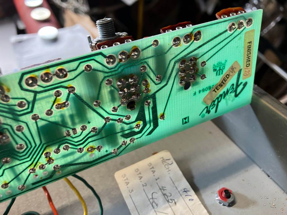

JGale Posted March 1, 2024 Posted March 1, 2024 It’s got a circuit board (grrr). I need four potentiometers, the first four on the first channel, one of them switched. Also a jack, all for PCB mount. What fun we will have. 💩

velorush Posted March 4, 2024 Posted March 4, 2024 '72 with a PCB? (Interesting) news to me. I've been in more than a few in the silver-faced era and all I've seen were turret board. I thought PCB started in the mid-eighties.
JGale Posted March 4, 2024 Author Posted March 4, 2024 It’s a red knob “The Twin”. Did I read the serial number wrong…again?😱
Tortious Posted March 5, 2024 Posted March 5, 2024 Red-knobs were like 86-89-ish, and it continued with black knobs until about 93. The pots/jacks directly to the boards have always been a bit problematic, but they are great amps (so I think), and usually can still be found quite cheap. Edit - the serial numbers are kinda useless for dating. There's usually a date code, like a 2 letter thing or similar, on the tube chart or some sticker on the inside.
HSB0531 Posted March 5, 2024 Posted March 5, 2024 On 3/1/2024 at 4:14 PM, JGale said: It’s got a circuit board (grrr). I need four potentiometers, the first four on the first channel, one of them switched. Also a jack, all for PCB mount. What fun we will have. 💩 For me, the hardest part of working on older gear, is finding parts. Caps are especially difficult because the sizes are much smaller than they were for a given voltage and capacitance. IC's are harder to find in socket mount packaging too. Resisters are still easy to source though. Pots are a little tricky because of the mounting style, shaft type, and whether they are linear taper or Logarithmic. Here's some info on types of pots and markings used: https://eepower.com/resistor-guide/resistor-types/potentiometer-taper/# The pots on the circuit board are usually linear taper, but a few amp designs have required audio (log) taper.
Dutchman Posted March 6, 2024 Posted March 6, 2024 That's not a 72. Sorry. I used amplified parts for most parts. I'm sure it's just a spin off of some larger sales store. The PCP stuff is relatively easy to fix. But it does require exaxct fit. Pull one out and should have a part number. Then possibly Mouser might have the part in inventory yet. I had to replace all the pots on a 90's Peavey bass amp a while ago and sourced them out of mouser. Good luck!!
HSB0531 Posted March 6, 2024 Posted March 6, 2024 16 hours ago, Dutchman said: That's not a 72. Sorry. I used amplified parts for most parts. I'm sure it's just a spin off of some larger sales store. The PCP stuff is relatively easy to fix. But it does require exaxct fit. Pull one out and should have a part number. Then possibly Mouser might have the part in inventory yet. I had to replace all the pots on a 90's Peavey bass amp a while ago and sourced them out of mouser. Good luck!! I use Mouser also. They seem to have the most inventory and the widest range. One item that's been an indispensable tool, is my digital caliper. I use it to measure small parts to figure out what fits and what doesn't.
JGale Posted March 7, 2024 Author Posted March 7, 2024 So, I can find the stereo input jack (J1 on the schematic) but the pots are proving troublesome. The existing has flat D shafts which are a no go everywhere I’ve looked so far. I can find their round shaft equivalents, even with PCB mounting. Can D shaft knobs (like the ones on the infamous Red Twin) be drilled out for a round shaft?
Dutchman Posted March 8, 2024 Posted March 8, 2024 https://www.ebay.com/itm/374853470781?chn=ps&norover=1&mkevt=1&mkrid=711-117182-37290-0&mkcid=2&mkscid=101&itemid=374853470781&targetid=1529493983942&device=m&mktype=pla&googleloc=9020386&poi=&campaignid=19851828444&mkgroupid=145880009014&rlsatarget=aud-1306613350219:pla-1529493983942&abcId=9307249&merchantid=6351864&gad_source=1&gclid=CjwKCAiA6KWvBhAREiwAFPZM7o2Neb5B0aUlER1LS7kmZ7QpFpfIzwOVc9mpky2JshirB9cZvrPLfxoCcrIQAvD_BwE Angela has always been good to work with for me. Kinda pricey... but... you know....
Dutchman Posted March 8, 2024 Posted March 8, 2024 Here's one I have not used. See if any of these look right. https://images.app.goo.gl/BstxHYh255txyHX39
JGale Posted March 9, 2024 Author Posted March 9, 2024 Yay! 👍✌️😎 I found all four components I need at Tube Amp Doctor..in Germany. Made to fit Fender The Twin! tubeampdoctor.com
