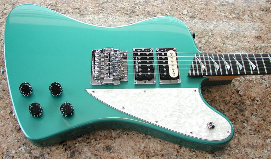

BadgerDave Posted February 9, 2010 Posted February 9, 2010 Quick word of caution to anyone who may be considering picking up this body and adding a Warmoth or Stat neck. The intonation will be off. I purchased what may have been the last Cali neck sold on ebay several years ago to use on this: I had to order the body with a custom bridge placement. The standard rout would not work with the Cali neck. IIRC the bridge had to be moved 5/8" closer to the neck pocket. So, if you don't have a Cali neck, you'll likely need to do some major modifications to the body or neck to get the intonation right. I don't know if a Diablo or Chap neck would work. I'm pretty certain a Daytona neck wouldn't.
