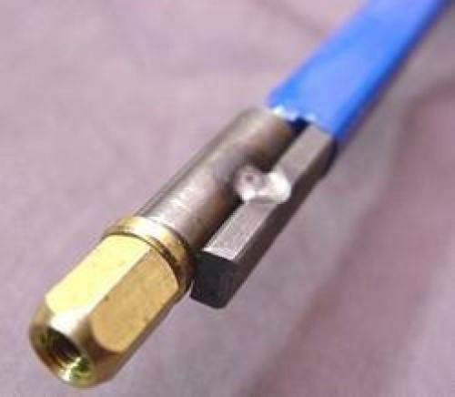

Soooo, are are most truss rods created mostly equal, or am I being naive? I was looking at LMI's new 3 way rod ($37 CAD), Stew Mac's two way Hot Rods ($25 CAD), and a random ebay seller ($7 CAD). They are all steel rods and flex. I'm assuming it comes down quality of welds and threads? Get what you pay for?
Regardless, what's the consensus for HFC experts on who (and what) makes a kick ass truss rod? Dare I say the Hamer of truss rods......?
