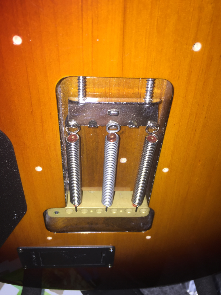

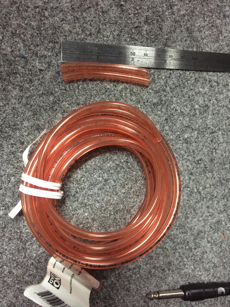

tbonesullivan Posted April 4, 2018 Posted April 4, 2018 So, during the setup of my Music Man Luke III when going from .009's to .010s, I had to add another spring. There was just no getting around it. The spring claw was already only about 1/2 inch from the end of the cavity in with 9s due to the saddles being pretty high. So, when I went to take off the springs, I found that there was a bit of tubing on the inside of the springs. I'd never really seen this solution before to trem spring vibration, but it definitely seemed to do the trick. Only problem was that I only had the two 2 1/2 inch lengths that were in the guitar, so I googled, and read that i should just go to Home Depot. I went there, and found 3/16 inch Outer Diameter fuel line, probably a 10 foot coil, and it's the exact same color, so definitely what I was looking for. I did find that the 2 1/2 inch length is a bit too long unless you've got a lot of stretch in the strings, so I went with 2 3/8 inch, which was recommended in a youtube video I saw. So, now my Luke III is set up for .010s, and the springs don't make any noise at all. Now that I've got a bunch of tubing, I will probably just put tubing on my other 4 guitars with tremolos, and still have a bunch left.

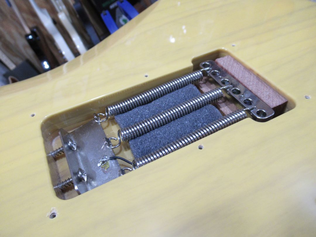

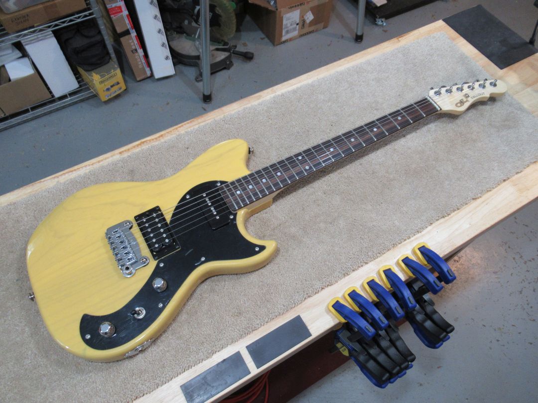

Jeff R Posted April 4, 2018 Posted April 4, 2018 Blocked trem example but same principle ... every now and then you get guitars that have some eerie odd isolated resonant frequency sonic vibration thingie going on due to whatever circumstance. Don't know why, just happens. This guitar had a strange underlying ring on the open "B" string and I traced it to the springs initially. A miniscule truss rod or string saddle adjustment, tightening or loosening the claw (the beauty of a blocked trem), anything physics related related really could or would have likely made it go away, but the overall setup and resonance was so good I didn't want to screw with it. Plus my shop bins include a metric shit ton of foam. I literally hoard it and amass it quicker than I use it, so into the cavity it went.
tbonesullivan Posted April 4, 2018 Author Posted April 4, 2018 Nice! I thought about the foam inside the springs, but with a moving trem it kinda can get stuck in between the spring windings. With the tubing it really seems to just slide around inside. But, to each their own.
