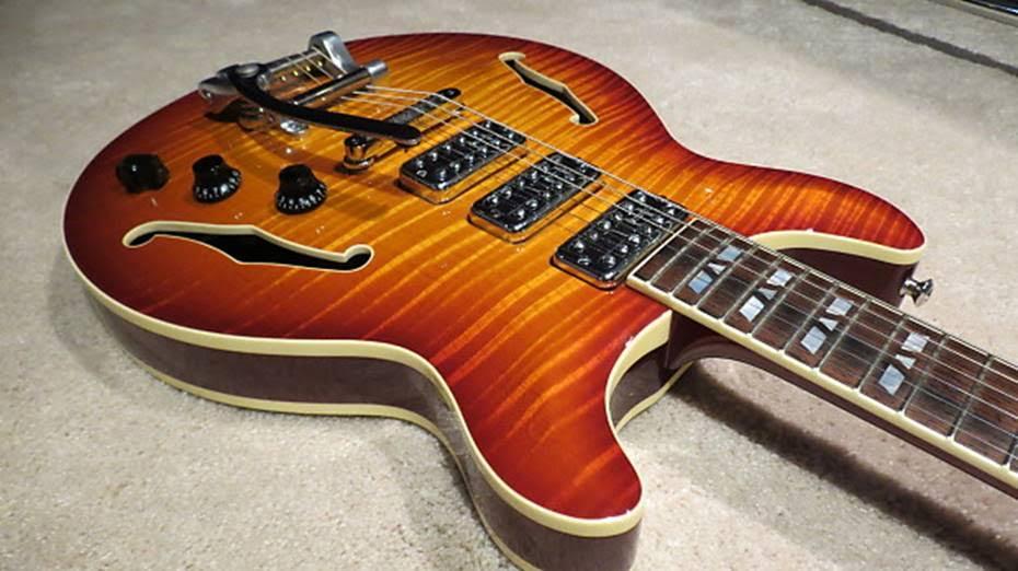

Camstone Posted May 15, 2018 Author Posted May 15, 2018 20 minutes ago, tbonesullivan said: What kind of bridge is on it now? Whatever TOM Bridge Hamer was using 10 years ago. It's this guitar. Thanks

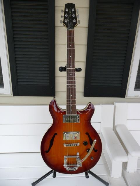

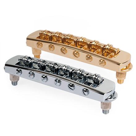

Camstone Posted May 15, 2018 Author Posted May 15, 2018 I bought another Newport last month that has a Schaller roller bridge on it and I like the way the Bigsby works much better than on the Tron Newport. But I haven't been able to find any info about whether you have to pull the threaded inserts to use the posts that come with the Schaller bridge. Here's the Newport that I just purchased (without the roller bridge). And here's the link to the Schaller bridge that's now on it: http://www.stewmac.com/Hardware_and_Parts/All_Hardware_and_Parts_by_Instrument/Electric_Guitar_Parts/Electric_Guitar_Bridges_and_Tailpieces/Tune-o-matic_Bridges/Schaller_Roller_Bridge.html It looks like it comes with two sets of posts, I just don't want to have to pull the threaded inserts out of the top of the Tron Newport.

Camstone Posted May 26, 2018 Author Posted May 26, 2018 Update. I got a hold of the guy that I bought the Jazzburst Newport from and he told me that the Schaller bridge is a direct replacement and fits on the Hamer posts. So I ordered one from Stewmac for $55.00 and it's the way. Thanks for the input guys.
gorch Posted May 26, 2018 Posted May 26, 2018 On 5/15/2018 at 7:04 PM, Camstone said: Does anyone know if there is a direct replacement TOM bridge with roller saddles for a Hamer Newport with a Bigsby? Meaning, a bridge that will fit on the same bridge posts. Thanks! I‘m using a Schaller. Perfect fit!

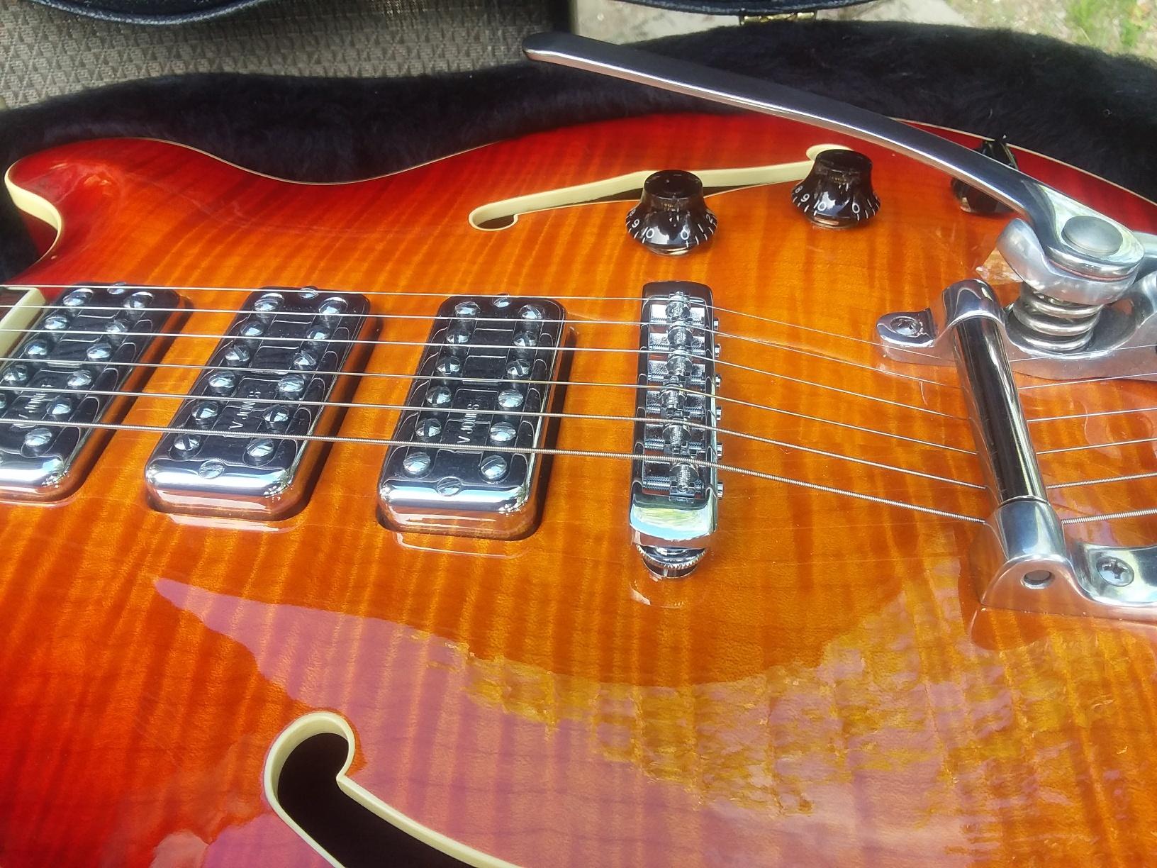

Camstone Posted June 2, 2018 Author Posted June 2, 2018 Here's the new Schaller bridge installed on my Newport Filtertron.
Camstone Posted June 2, 2018 Author Posted June 2, 2018 16 minutes ago, Jakeboy said: Looks great! Is it helping with tuning stability? Don't know yet. Just put it on this morning and got the intonation and string spacing set. Rehearsal with my band this coming Tuesday night and then three gigs in the next two weeks. More will be revealed. I'm also going to pick up a bit of graphite powder at the local ironmonger.
