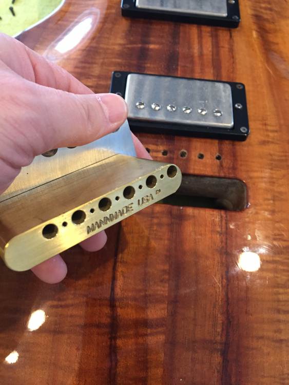

Travis Posted March 13, 2020 Posted March 13, 2020 I’ve searched several times for the thread I had posted a while back that had the answer but can’t seem for the life of me to be able to find it. before I pull the trigger I just want to be sure (I’m 97% sure but want to be positive) its the Mann made vintage trem that is a direct replacement for the Wilkinson vsv in the mirage, right...?

holLoWskull Posted March 14, 2020 Posted March 14, 2020 The older FIshman VMV Powerbridges I've used were originally made by MannMade. Both bridges I've installed were a near perfect replacement in terms of both trem block length and screw spacing for the stock Mirage Wilkinson bridge used on Mirages (even though they don't have the one elongated hole like the Wilkinson units do). I will give you one word of caution if your new bridge comes with 6 mounting screws that have a groove in them just below the screw head (lets the knife edges of the the screw holes in the bridge operate VERY smooth) and should you decide to use them vs. the stock Mirage/Wilkie ones be EXTREMELY careful tightening them into the body of the guitar. It's easy to shear the screw head right off if you tighten them too quickly or with excessive force (ask me how I know!). *MY OPINION* it's worth the mild hassle to install those screws vs. using the stock ones, and the extra girth in tone the MannMade adds over the stock bridge is nice on a 'slightly bright sounding from the factory' Mirage.

Travis Posted March 20, 2020 Author Posted March 20, 2020 It came today! Guess I know one thing I’ll be doing this weekend... now, a decision must be made...
holLoWskull Posted March 20, 2020 Posted March 20, 2020 A decision that has no wrong answer and two right ones...a good position to be in if you ask me 😉 Just go easy with the screw installation...it can quickly dampen the fun when you see a screw head spin off the screw body.

Travis Posted March 23, 2020 Author Posted March 23, 2020 Went with he Mirage 2. Big improvement. Sounds huge, much beefier. Trem is WAY smoother... Super simple install. I did need to deepen the holes for the 6 screws and then widen the top just a hair for the new screws to fit. And did I say that the function is super SMOOTH...?
