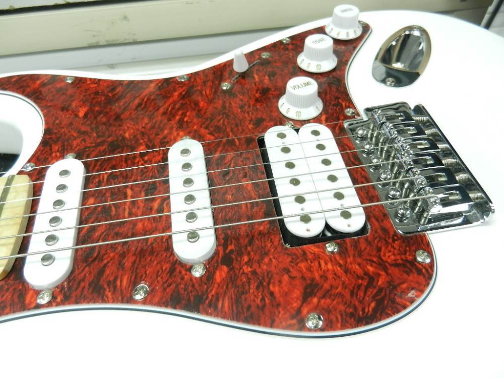

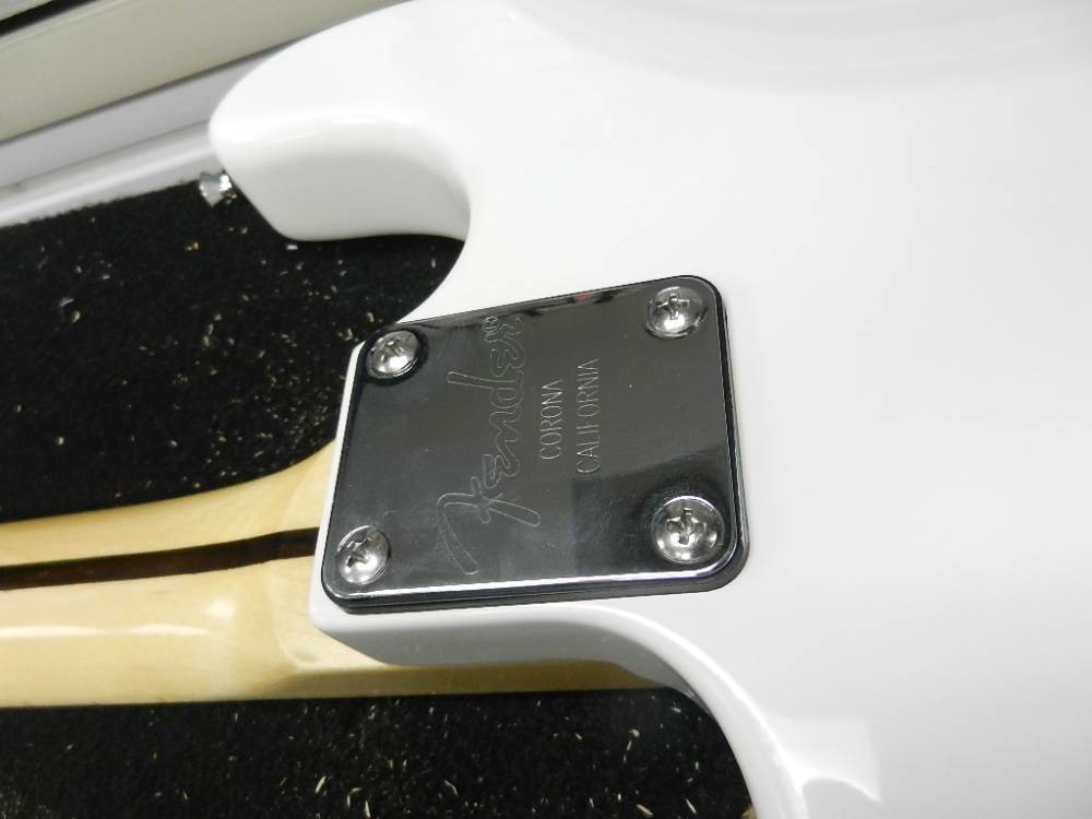

Jimbilly Posted April 20, 2022 Posted April 20, 2022 at a pawn shop locally, I'm thinking mutt, real neck and plate, but other parts squier?

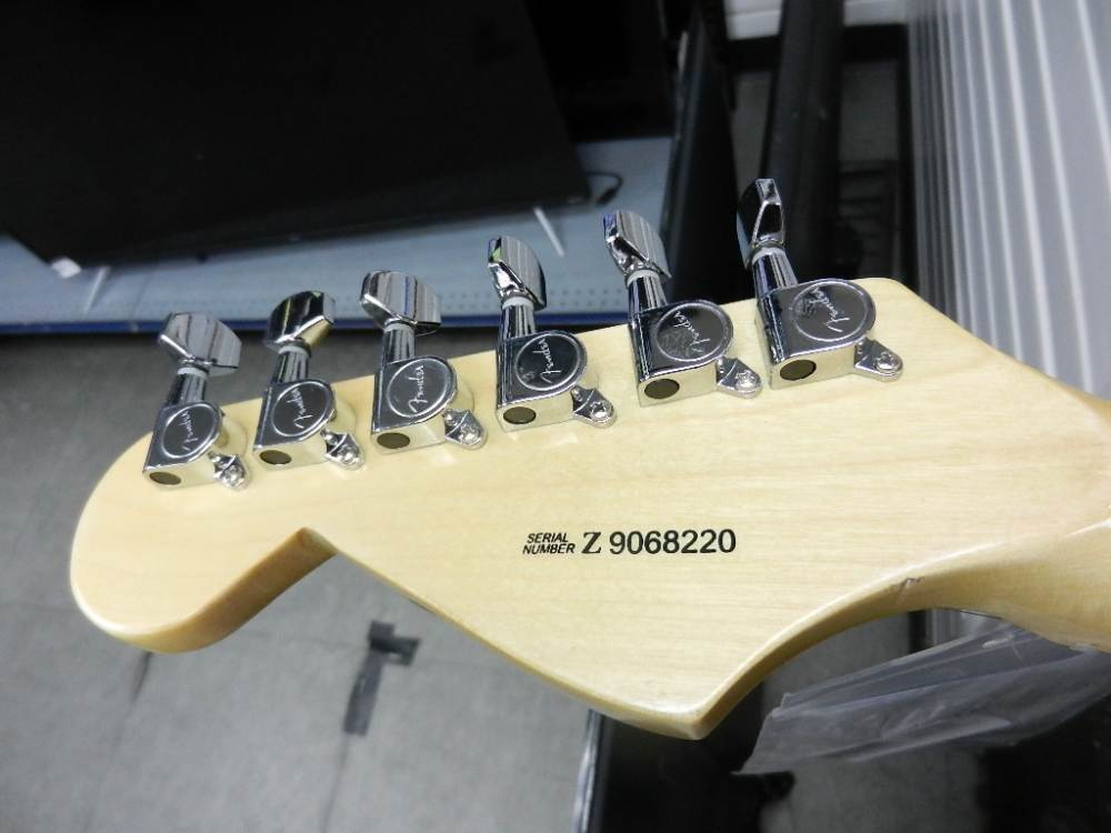

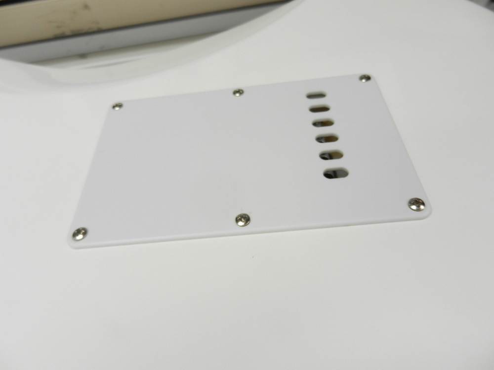

Victor (Fret Friend) Posted April 20, 2022 Posted April 20, 2022 That is not a Fender bridge (saddles are not Fender) or a Fender backplate. Backplate and pickguard should match. Serial dates it to 2009-2010 Corona. Pickguard is likely an upgrade as it has plastic film on it. As you said, it's likely a Squier body...

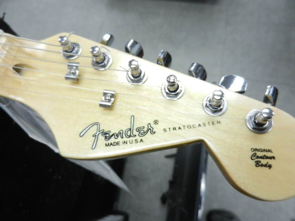

Tortious Posted April 21, 2022 Posted April 21, 2022 4 hours ago, Jimbilly said: Probably a Chinese fakecaster. The serial number font looks wrong, and that number is apparently common on fakes. Search around aliexpress, you can probably get a 'new' one shipped to you for like $200.
topekatj Posted April 21, 2022 Posted April 21, 2022 Could be the angle of the first photo but the ‘knob’ on the tip of the headstock just looks wrong, as well as the angle of the logo decal.
Jimbilly Posted April 21, 2022 Author Posted April 21, 2022 another thing that doesn't show up great in my photo (1st photo), the word STRATOCASTER is not very sharp, and a little worn looking for an otherwise low-mileage guitar.
cmatthes Posted April 23, 2022 Posted April 23, 2022 On 4/20/2022 at 11:42 PM, Jeff R said: Truss rod access hole looks Chinese. EVERY SINGLE TIME. Dead giveaway. Fender lines their headstock-adjust necks. Raw wood headstock hole is a cheap Chinese knockoff.
topekatj Posted April 23, 2022 Posted April 23, 2022 FWIW I’m seeing flat pole single coils and a humbucker with no adjustable pole pieces
