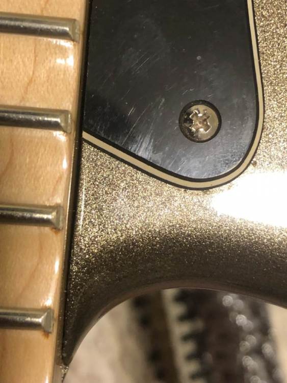

One of the reasons I did this is I have a guitar MichaelB gave me, but I never play it. So I thought I'd add a different neck to it. I intended to use the old Rosewood on Rosewood Tele neck on an old refinished Yamaha RGX body. The seller had a strat neck in it, I bought the body only...when it arrived, I found it had a tele neck pocket.  But, being Yamaha I guess, the screw holes aren't in a standard tele position.  So I filled the holes with epoxy and tried to drill new ones.  I must have screwed up the angle, because trying to drive the screws in, I broke one off in the neck:
I think what I did wrong was put the body face down on the neck, and try to hold it in position as I drilled.

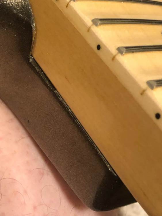

So this time I held the body vertically, put the neck in the pocket, and held it in place as I drilled.  Then put in the screws.
I think the drill bit I used was too small, because it seemed like the neck didn't fully seat on the bridge end.  Also, I'm not quite sure the alignment is actually correct.

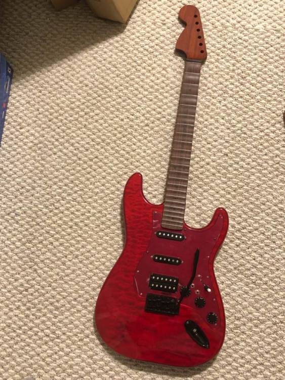

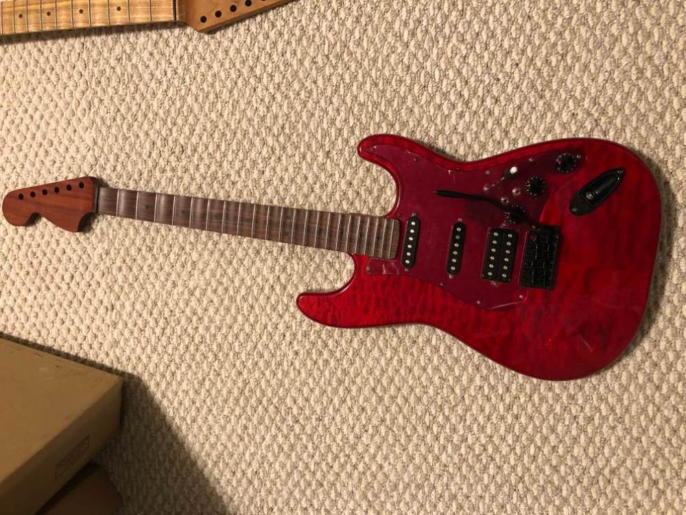

The guitar bodies in question, and the scalloped Canary fretboard on Roasted Maple (Warmoth made up for the bad Goncalo Alves figuring on this one):
If that weren't enough, BOTH of the quilted bodies I got, both of which the seller said previously had Warmoth necks in (different sellers), have the bolt holes in a non-standard configuration.
Dunno if you can see it, but it's like the neck pocket is just 1/8th of inch too short for the screws to go in.  So I'll have to epoxy and redrill TWICE.

24 minutes ago, Dave Scepter said:
That screw will be a bugger to get out... Next time lubricate the screw with soap
oh...
I guess I should have asked before trying.
Thanks.
Nate, may I suggest some decaf?
That broken screw is going to suck. If you have a Dremel with a thin abrasive disk, you could cut a slot in the top of it and - maybe - back it out with a screwdriver. Good luck!
2 hours ago, Nathan of Brainfertilizer Fame said:
oh...
Thanks.
Did you drive the screw in with a drill and bit?.. if so, DON'T..
 Make sure you screw it in by hand with a screwdriver 🪛
I always clamp the body to the neck "using the body holes as a guide" while drilling the neck..  but 1st (mark the depth of the drill bit with tape) so you don't drill through the fretboard
Yup. Soap (or beeswax) is a must. I go in three ticks (by hand) and back out one. 3 in, 1 out.  Keep repeating until done.  If it starts getting too tight (purely a judgement call), I back out all the way, reapply the wax, and start again.
I'm no expert, I've only drilled neck holes once, but did the put both E strings on, line up and clamp before I drilled.  Love that grain though!
Yes this... use both E strings as a "straight edge  keeping it all aligned
that makes sense, too.
I have assembled guitars before and never had these kinds of problems. I guess I had just been lucky.
Ok, so you've screwed the pooch, but it's fixable. Get a small high quality vice grip with a pointy nose on it. Not one of those long jaw jobs but a shorty that has some good grip. Then carefully drill around the screw just enough to get a damn good grip on it. After the screw is removed, find a piece of Rosewood and cut a plug with a 3/8 or 1/2" plug cutter. Then carefully bore with forsner bit or a hole bore drill ( the plug cutters and hole bore should be in the same kit for perfect fit) glue and clamp the plug in. Then cut the plug off flush and sand smooth.
That's how I'd fix it if you brought it to me. Oh and keep the grain the same on the plug. You have to look for the repair when completed!
https://www.lowes.com/pd/Milescraft-3-Piece-Plug-Cutter-Set/50192299?cm_mmc=shp-_-c-_-prd-_-tol-_-bng-_-PLA_TOL_215_Power-Tool-Accessories-_-50192299-_-Online-_-0-_-0&ds_rl=1286981&msclkid=a953d3d5882511e822f5b0dc85a7f3b0&gclsrc=ds
And a third "this". There is no better straight edge than the strings, you can easily get it perfect.
7 hours ago, Nathan of Brainfertilizer Fame said:
Any suggestions on how to get it out?
In the future, drill holes that are 1 size smaller that the screw you're going to use. Coat the threads of the screws with small amount of bar soap before screwing them in.
If you snap a screw, there are several kits available to remove them.
