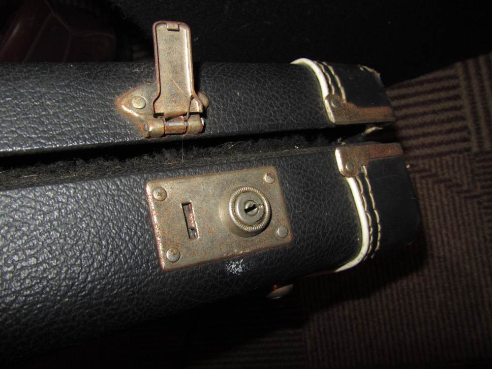

I've got an '80s Ibanez hard case with 2 broken latches, the spring-up kind and the center 'buckle' type.  The good latch says "Cheney" England, which is not what I would have expected.  Tips for parts sources and repair?  If I can find similar parts, I might be able to bend/crimp in what's missing.

I’ve found case hardware on eBay. You have to thoroughly measure the parts before ordering. Most shoe/leather repair shops also do luggage repair. My local guy has fixed two or three cases for me. Often they can find the parts or have reasonable facsimiles. For instance, guitar case latches are basically the same ones that are used on many briefcases.

This one,     it looks like you might be able to remove the pin at the hinge with Pliers etc...
swap it out with another good part,  and then you might be able to crimp a new pin with pliers
or tapping it with a hammer      That might be an easier path than removing the whole part...
or,  maybe just replacing the part that popped out...  and then bend the tabs back
edit:  looks like the old cheney latches ones don't match the new ones...
