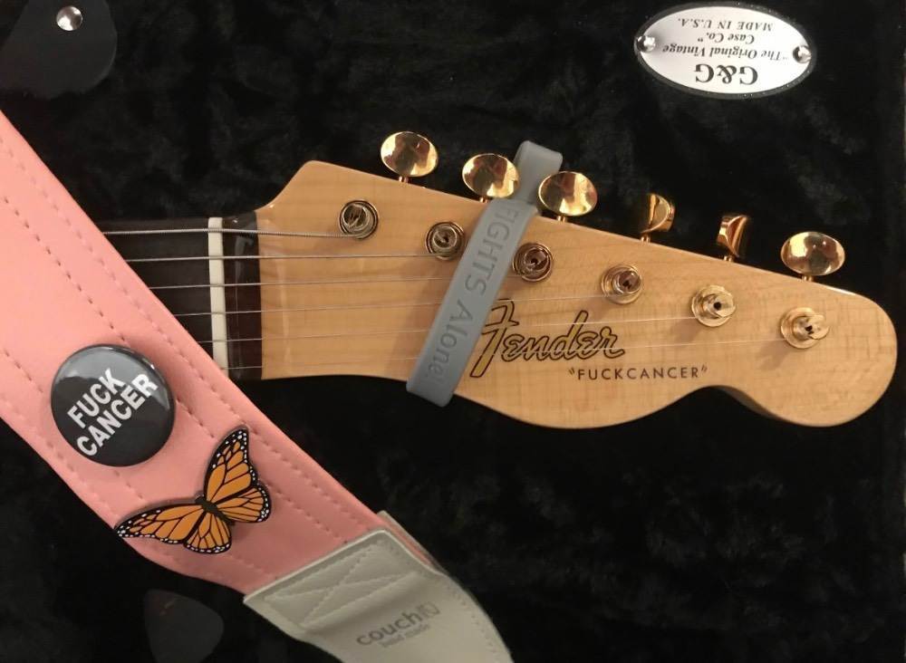

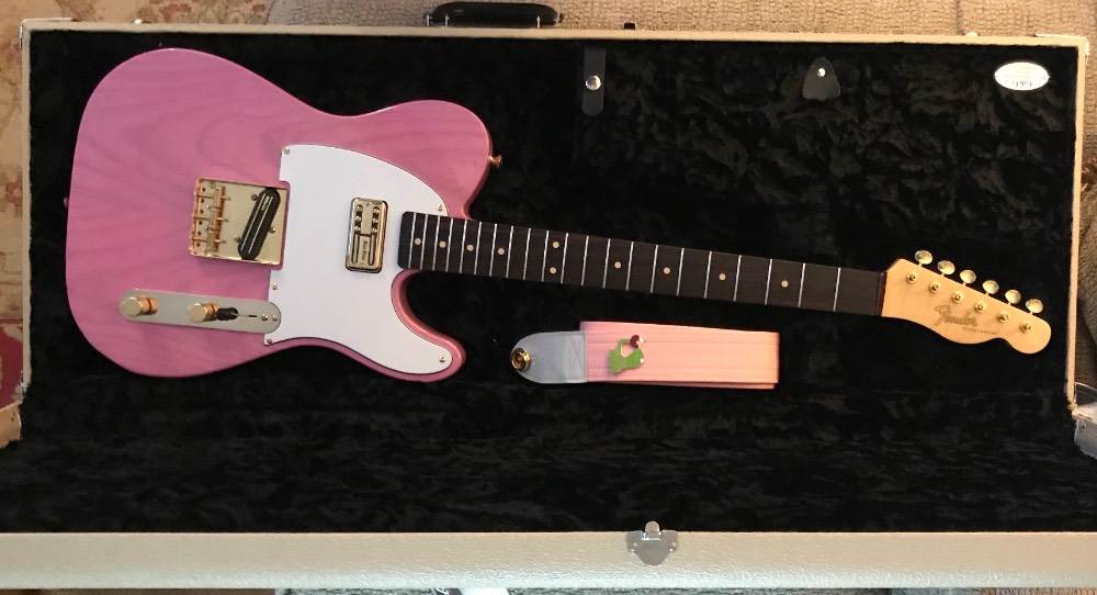

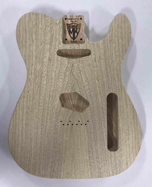

Best all-around?  Musikraft.  I swear by their Tele bodies.  Hands-down, the best.  I’ve also been a huge fan of their necks, but Steve Parker (ex-Musikraft fret guy) at Parklane is now putting out killer necks.
Musikraft body, Parklane custom neck;
Musikraft body and neck:

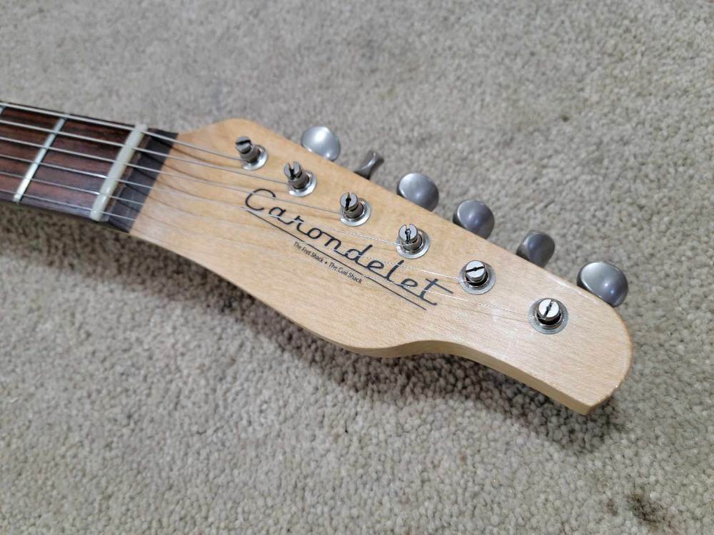

Segue to my most recent "not for sale" ... Ash and rosewood, MJT paint/body, Fujigen/Allparts neck, Carondelet 90 and Carondelet Modern 5 (hidden push/pull in the tone control splits the H), Gotoh hardware (including staggered post tuners). I cannot put this guitar down.

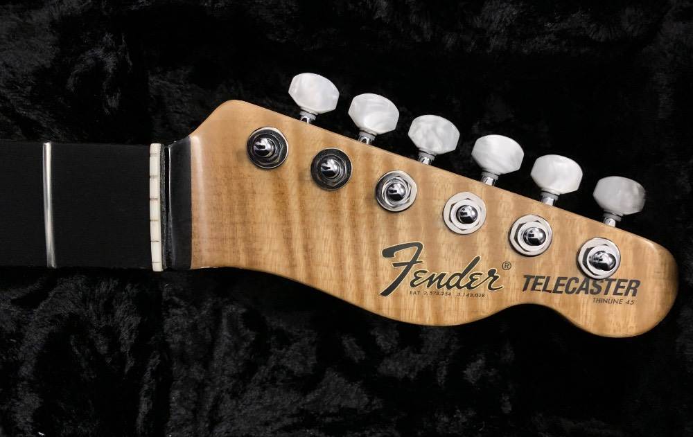

i see no string trees, are you using graduated post tuners? Also see that Musikraft doesn’t list swamp ash as a wood option for bodies any longer-  is it pretty much unobtainable at this point?
I usually go with staggered and/or locking tuners on builds, and they win out on the two above.

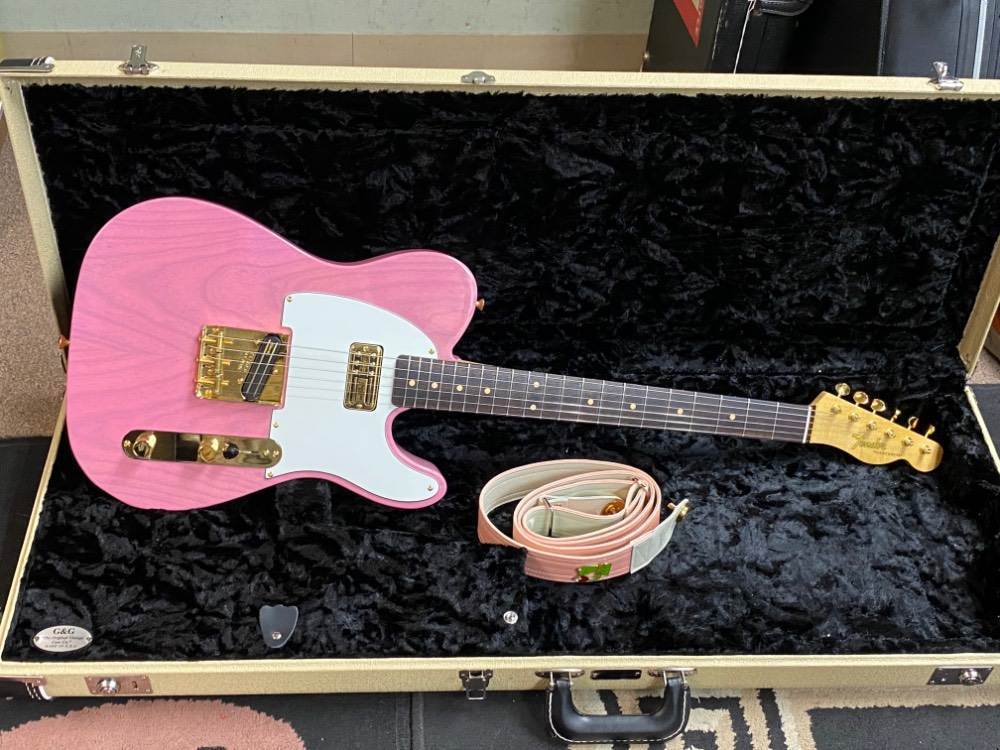

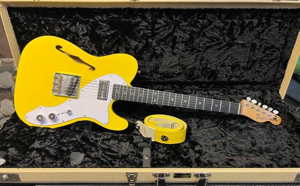

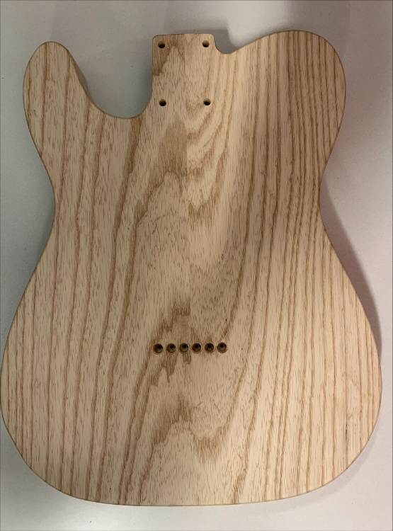

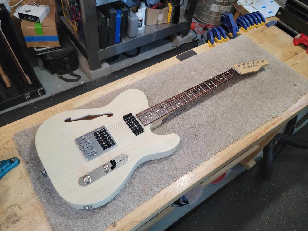

As far as Musikraft and the availability of nice Ash, definitely reach out.  I got the pink hollow Tele body - no F Holes) right before the pandemic (December, 2019, I believe), and it came out so great, I later ordered another hollowbody Tele just like it, and then another hollow Ash body with a White Limba/Korina top, just for kicks.  The yellow Thinline is one of their Roasted Ash Thinline bodies, and I think I ordered that last December.
The wood quality and work is fantastic - great figuring/matching and all of the bodies weigh well below 4lbs.  Hopefully, they'll offer an Ash option again for Teles.  I've got two of their lightweight Alder and one light Ash Strat bodies around here as well that are also either right at or just a little under 4lbs, which is perfect for me.
