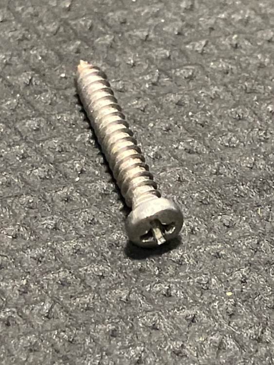

Jimbilly Posted May 14, 2024 Posted May 14, 2024 You know, those rounded and small phillips head screws that just fit inside a Dunlop strap button. I seem to be short a couple, I'm sure they're only a few bucks for a ten pack on ebay, if I can find them.

RobB Posted May 20, 2024 Posted May 20, 2024 This is the screw: I couldn’t find this on the McMaster site.

Jimbilly Posted May 29, 2024 Author Posted May 29, 2024 Coincidentally, some smaller screws fit just fine in the Dunlop button, like the wood screws that are stock with a Tokai LC60 (the gold one on the left), and it's better to use the stock screws than to drill out the holes to fit the bigger screws, or force the bigger Dunlops in. The stock screws do go a little bit deeper than with the original buttons, but not too much of a force-fit.
Jimbilly Posted June 3, 2024 Author Posted June 3, 2024 a couple of final thoughts on this, after a trip to the hardware store: It seems that a #5 wood screw fits in the strap button, and holds in the guitars (6 head is too big). Most of my guitars have the Dunlop straplocks, but not all. I have hesitated to 'hog out' the strap button holes for the bigger Dunlop screws in a couple of guitars: the stock screw in the '81 Special, the Proto ii, and the '84 Tokai all seem to be a #5 wood screw, and a 5 x 3/4 (photo) holds fine in those guitars. It would probably be better to drill a little bit deeper and use the 5 x 1 screws to avoid any failures, I think I will put those in the Proto and the Special. I like this idea better than drilling out the guitar bodies for the larger (#8?) Dunlop screws. The heads on the Dunlop screws might be "trim" heads, these longer "trim" screws look like they would fit, but I did not try them, I couldn't find any loose in the bins to try out in the Dunlop button I brought in. I also didn't see anything shorter than 1 1/2" with the trim head.
