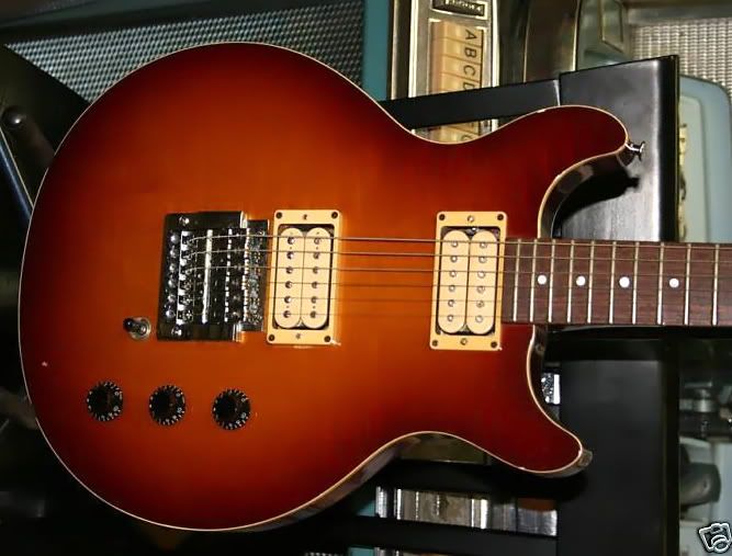

There is this Sunburst that I have been looking at that has the locking nut installed on top of the truss rod cover, not right after the nut like it is on most any other guitar that I have seen.
Was this installed by a drunk? Or has anyone seen this Kahler nut installation on other guitars and knows of it's efficacy?

On Kahler equipped guitars, the truss rod cover is cut short and butts against the locking clamp. There is so much crud on that guitar, it just LOOKS like it's over the cover. It's also strung very poorly....make sure the guitar is CHEAP.
Well, my eyes say the trussrod cover is cut to fit.
As far as what was installed by a drunk, not sure about the Kahler, but I'd say the strings sure were! :rolleyes:
I'm not too sure about that one. I don't know how expertly the Kahler was installed altogether.
Agreed that I'd avoid unless it was CHEAP.

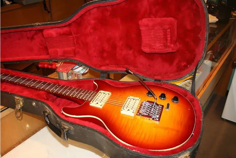

Hmmm... the guitar is $499 and it looks to be in pretty good shape otherwise. I wonder if that price is too high for a Kahler'd 1982 Sunburst? I've got six Hamers now... I don't really need another one, but it is awful tempting.
It's very interesting to know that Elduave has seen Kahler'd Gibsons with the locking nut fitting over the truss rod cover.
Is that how Kahler mounted their locking nuts in 1982? The base plate doesn't even say Kahler, is that how the early models were made? Here's some more pics.

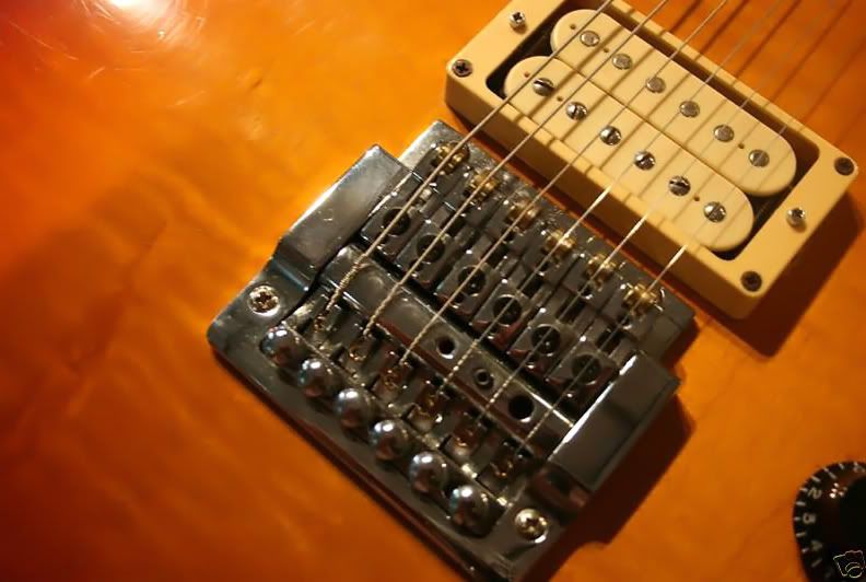

That Kahler is not original to that guitar. It is an aftermarket add-on, and that particular bridge is probably 3-5 years younger than that Sunburst.
I haven't seen pics of the back of that one, but I'll bet you a half a $20 that there are string-thru ferrules back there. You know why? (Why, Chris?) Because it left the factory with a Sustainblock! By the time you restored that one to a passable state (removing the Kahler, replacing the Sustainblock, getting the route filled, the top patched and finished, etc.), you've just doubled what you paid for it, if not more. You're in the price range to buy a straight Sunburst now - one that you'd be able to get your money back out of if you wanted to. This one will always just be a repaired guitar that isn't worth what you'd have into it.
The Hamer-installed Kahlers that I've seen did have the properly-installed locking nut. That nut is also different than the one Gibson used that Elduave refers to above.

Ferrules on the back is such a dead give away... I feel like a retard that I didn't notice it! lol!
