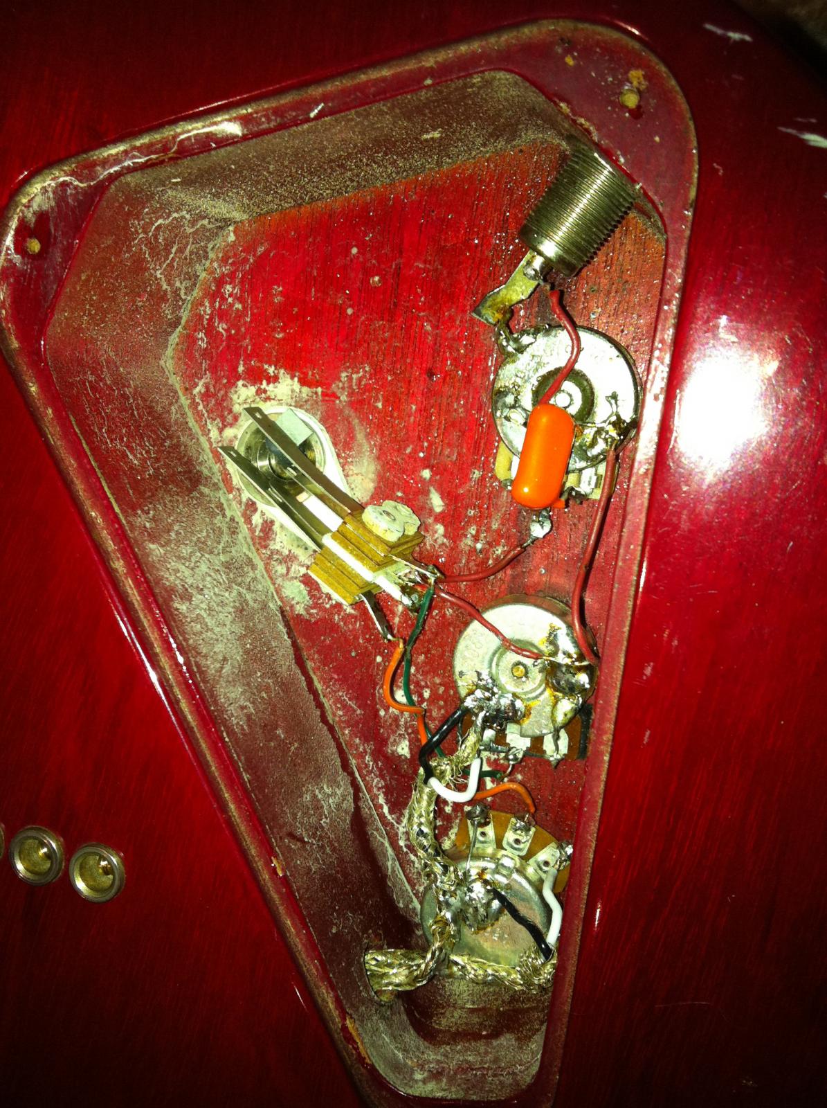

GooCart Posted March 16, 2012 Author Posted March 16, 2012 Today was wiring day. We have a trainee at the office, he's one of these electronic wizards and I asked him to wire up the guitar for me. Much more fun for him than to serve us old farts coffee:) Anyway, we didn't really know much about the wiring, I haven't found any schematics for the '78 so we guessed some but I think we got it right. It's wired out of phase, I think that's how they was done but correct me if I'm wrong. The switch doesn't look like any Hamer switch I've seen on photos on the Internet so it might be replaced but I don't know. The pots are Dimarzio, I think that's correct but I'd like to hear what you experts say, did we do something right here and does any parts look original? Oh, i totally forgot. The guitar sounds amazing, with full throttle in middle position it's instant Peter Green, turn one of the volumes down and you have a completely new spectra. Both the neck and bridge pickup are amazing. I love those old Dimarzios and have a set on all my user guitars.

GooCart Posted March 16, 2012 Author Posted March 16, 2012 Yeah, I did a search but I just found a archtop sunburst. It's kind of similar to this but with single conductor pickup wires. What bothered me most was the switch, it looks quite different from the photos I found. No biggie, this switch works just fine but you know how it is. For me it's not worth doing if I'm not doing it right. Well at least within reasonable basis:)
Disturber Posted March 17, 2012 Posted March 17, 2012 Yeah, I did a search but I just found a archtop sunburst. It's kind of similar to this but with single conductor pickup wires. What bothered me most was the switch, it looks quite different from the photos I found. No biggie, this switch works just fine but you know how it is. For me it's not worth doing if I'm not doing it right. Well at least within reasonable basis:)My 79 has un touched solder joints. I'll shoot ya a pic. The pups are wired out of phase in the middle position. Other than that I think it's wired the standard Hamer way.
RichRS6 Posted March 17, 2012 Posted March 17, 2012 Heres my 78 if it helps. Not sure if its untouched or not, I haven't touched the wiring but that's not to say a previous owner hasn't so I will be interested in peoples thoughts. (Edited to say) Actually, it has been touched as one of the pots was replaced before I got it (I still have the original in the case). Looking at it it seems both the black wires from my P/Us go to ground, does this mean the middle position is not wired for out of phase ?
Mindseyes Posted March 17, 2012 Posted March 17, 2012 Awesome guitar!!! Here is a couple shots of the control cavity from my old '78 hope they help
GooCart Posted March 17, 2012 Author Posted March 17, 2012 Thanks for all your photos guys! I see clearly that my switch and input jack differ from yours. I wounder why anybody would have replaced them, but stranger things have happened. I looked in the control cavity of my '79 and it also have the same switch as you but it also have some kind of extra capacitors on the volume pots. The wire color looks kind of random. I've seen both red, yellow and blue. My '79 have the blue wires.
GooCart Posted March 18, 2012 Author Posted March 18, 2012 So I did some comparison between this guitar and the '79. The neck angle on the '79 is 3.2° and the headstock angle is 15.5°. It weights 4.1 Kg. This guitar have a neck angle of 2.5°, a headstock angle at 14.5° and weights 3.4 kg. The neck meets the body exactly at the 21th fret on this guitar, it actually deforms the pickup ring some. On the '79 the neck meet the body 3-4 millimeters closer to the 22th fret.So the specs differ quite much, both the angles and some of the electronics, I also have my doubt that the switch would be replaced since it have exact the same patina as the rest of the hardware. This makes me wonder, can this be a earlier model than '78 or is it common with these variations?
