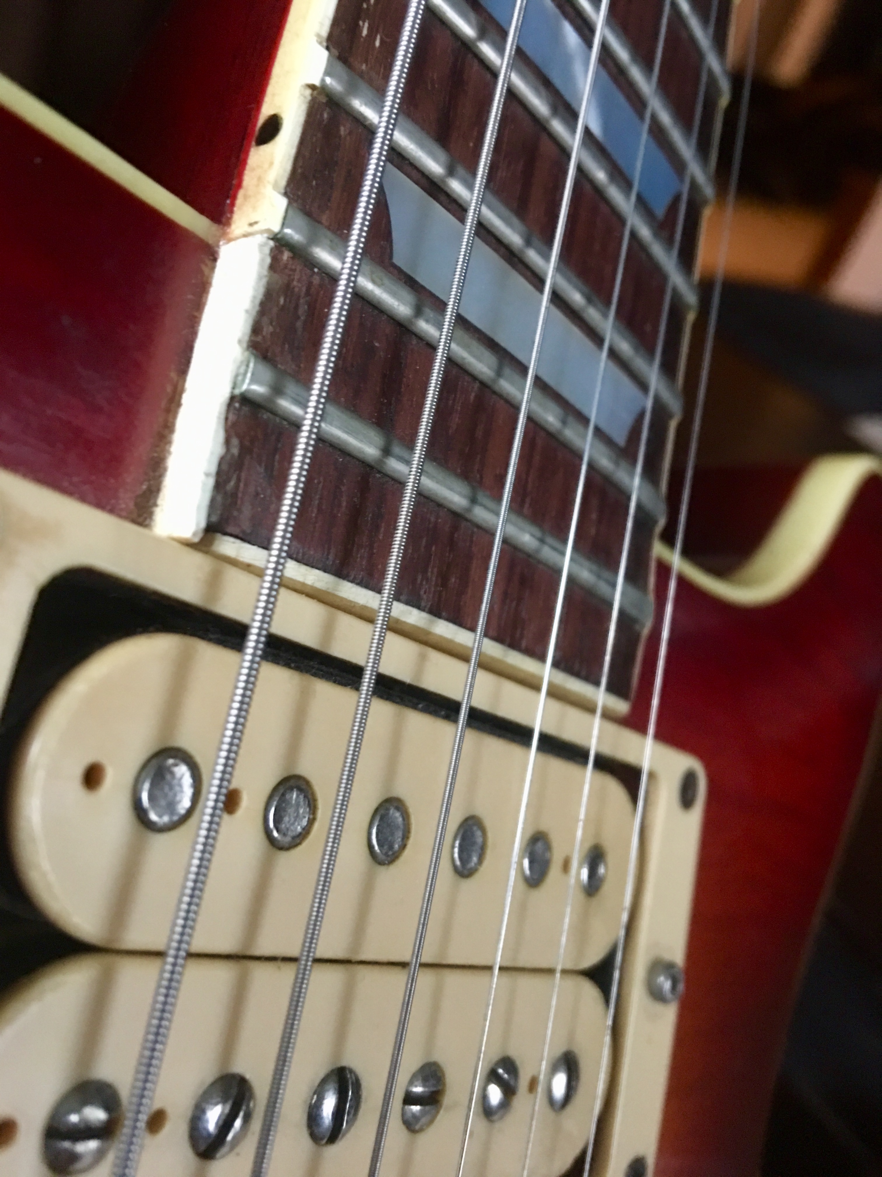

Got this early Sunburst. Seller disclosed body was busted/repaired, due to jealous girlfriend but NO break to the neck. I got it and can see the heel was also repaired, thus broken along with body. Section of binding in the area replaced (incorrect material), one non-original tuner, and though repair respray finish was pretty good, they used BROWN, instead of the proper red in the burst. Why?!!!! None of these were disclosed. I should also mention the neck angle now, isn’t what it should be, which I believe is due to the repair taking a way a bit of original back angle. Upper frets will also need leveling. Saddles can’t go any lower and action is just ok. Ideally, I’d like it a bit lower. He admits he doesn’t know much and wants to make good. I’d like to keep the guitar, but feel it should be valued less due to the mentioned items. He asked what I think is fair. Cost was close to $1500. What do you all think would be a fair partial refund amount? I’ve an amount in my head, but wonder if too low? Let me know what you’d ask. Thanks!

depends on the break. need a pic of the heal to body around the backside, sides, the tongue shot inside the pup cavity.
just from the one pic, it looks botched, and string height looks high, rickenbacker high.
do a simple test as well to see if the "repair" is valid before taking all down...
plug the guitar in, volume till you here the strummed strings.
set guitar on work bench, laying body on bench, raise the neck with left hand, strum, "bob" the headstock up and down while strings are sounding.
If you get a decent, "concerned" pitch warble... not good. you could do another guitar for sound/ warble reference.

To fix it right is going to be expensive (been down that rabbit hole). With all the problems you've listed, getting at least 1/2 your money back is not unreasonable (but still won't be enough). Sorry to hear of your bad luck. That sucks.

The repair was not done very well or professionally at all.  Ergo the repair reduces the value of the guitar along with the damage it sustained.  I would not keep that guitar.  However, in my opinion the dollar value of the damage is at least 50% of the guitar.  Despite the undamaged value and the niche collectible status, I would not see the guitar being worth more than $500 as-is.  The poor repair job suggests a lot of risk for further problems down the road, resulting in a worthless guitar.
