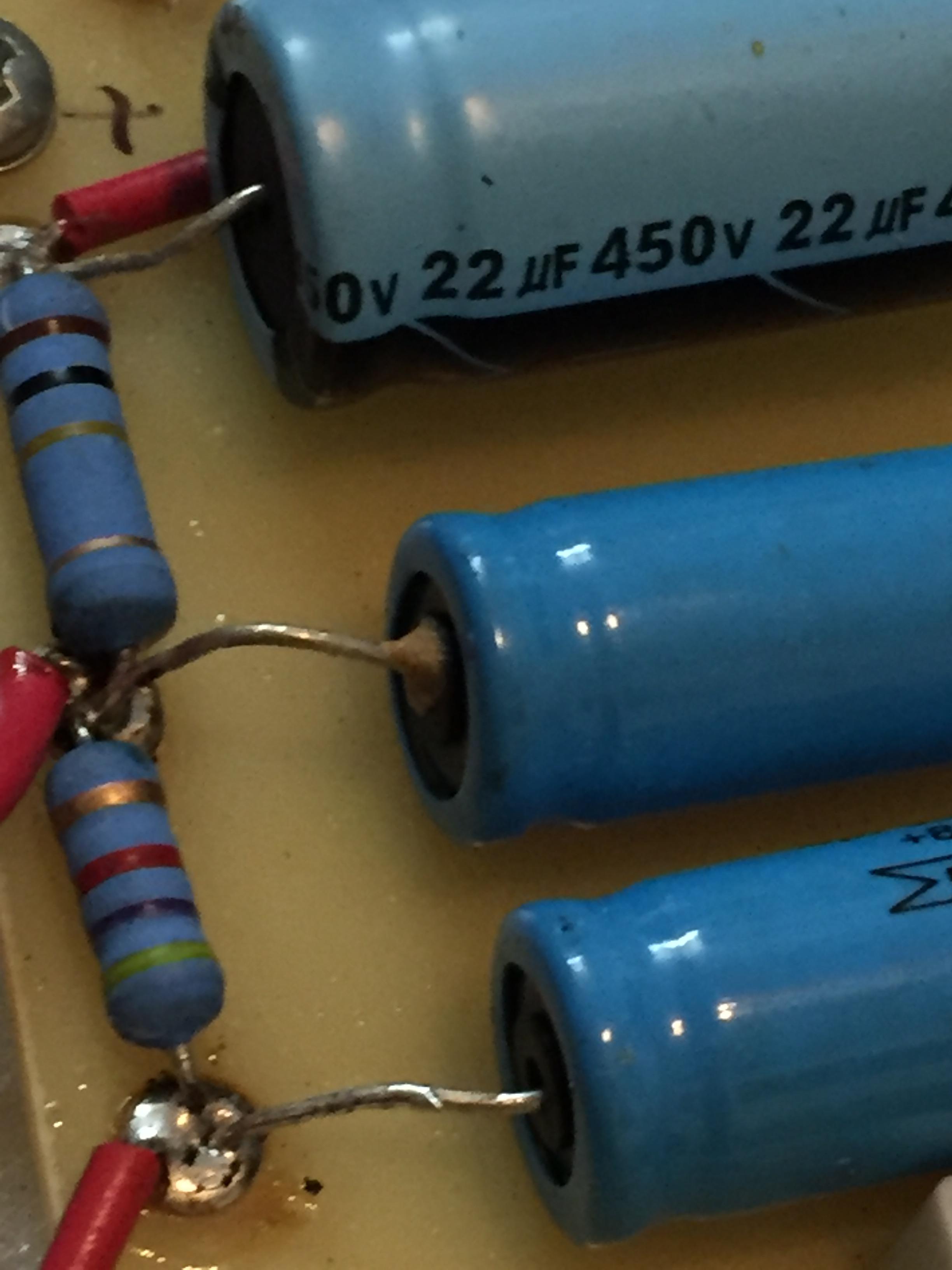

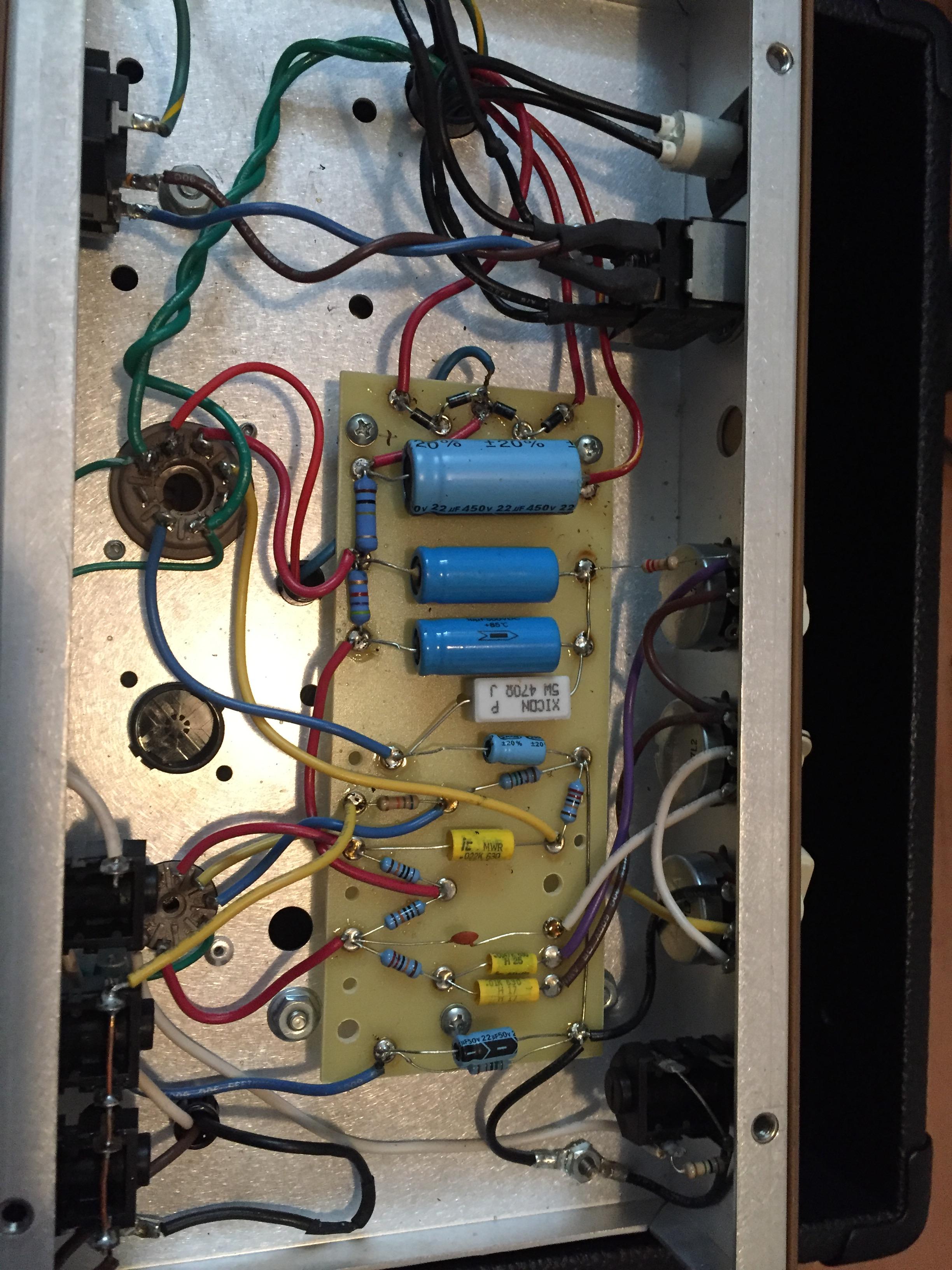

Just opened it. Haven’t done anything else yet but, I immediately noticed what you see in the first pic. Is that a sign?
Yeah. That capacitor is leaking or corroding. Even if that wasn't the source of the noise I'd probably swap it out. The soldering looks a bit rough but not terrible. That's a nicely put together Champ clone. I'm going to have to check those out.

That capacitor could definitely be the problem.  I recently had a new hum on my old princeton reverb.  Opened it up and there was a filter capacitor  that looked very similar to this.  Replaced it and it was super quiet again.

Those electrolytic caps have a shelf life of 10-12 years, after which they will have drifted and are no longer of the advertised value. They can be 'reformed' in a controlled manner, but just turning the amp on and using it can reform them too, but in an uncontrolled manner. Looks like the one cap didn't take to the reforming too well... I'd replace all three with new if'n it were mine. Not necessary, but I'm a little over the top with a lot of things.
