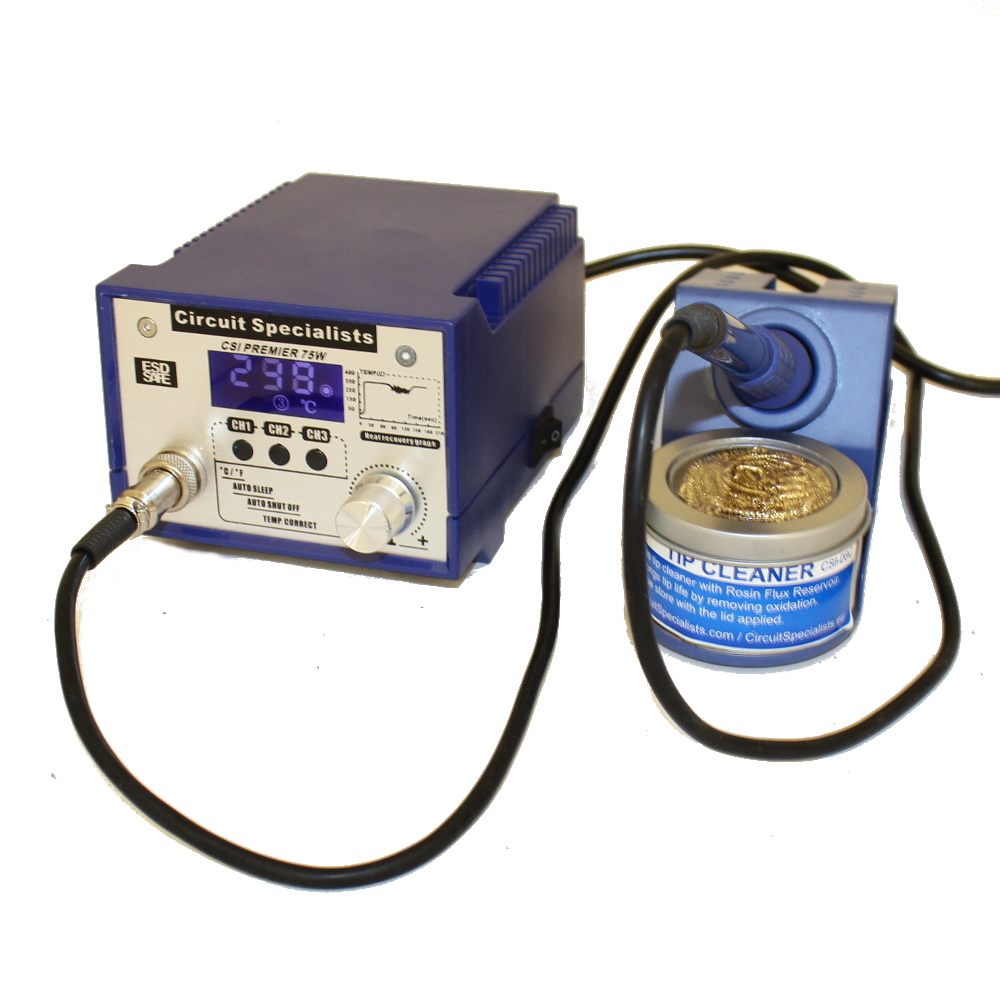

Jeff R Posted November 14, 2022 Posted November 14, 2022 https://www.circuitspecialists.com/csi-premier-75w-Soldering-Station.html is the station Murkat Jay recommended to us years ago that is now among my shop's daily MVP tools. I have two of these stations, one on my repair bench, one on my pickup winding bench. I personally want more than 40 watts. I use higher heat and get in and out fast versus using half-heat that's parked on and heating up the components longer.
