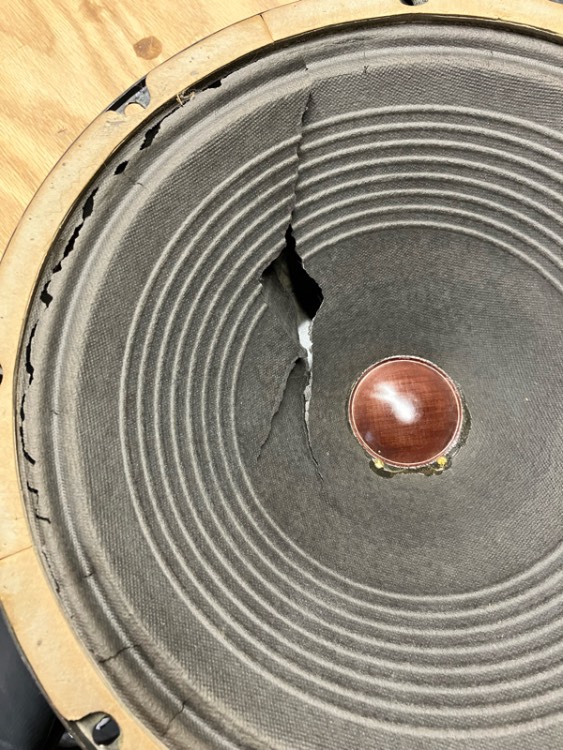

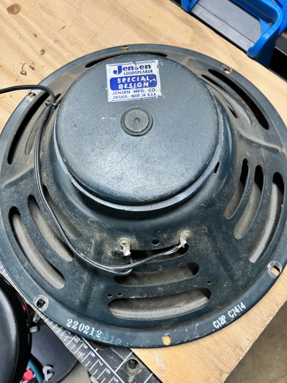

I have a C12P Jensen Special Design here needs re-coning. It's yours for postage. Picture as soon as I can figure this iPhuck thingy.44065DF5-3D8B-415A-803E-BD6ADE5B156C.jpegC7A551B4-B0A0-4C72-9A20-72867925C67F.jpeg
Send that Jennie to Weber for a recone!
