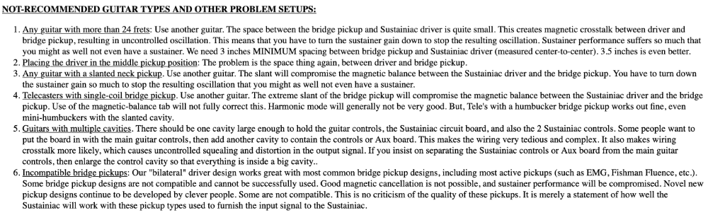

diablo175 Posted December 14, 2023 Posted December 14, 2023 If the mini toggles were indeed for a sustainer system, the installer royally fucked up- Sustainiac clearly notes on it's website that slanted pickup cavities and/or positioned less than 3 inches from the bridge p'up will not work for a sustainer system. 🙄

diablo175 Posted December 15, 2023 Posted December 15, 2023 18 hours ago, JustKid said: I think we already had this argument, as I mentioned before, I had quite a few guitars with sustainers, including Cali, most of them factory, some with aftermarket, and can with absolute certainty report that it works just fine. So may be some things on the websites need some fresh look. In one famous book it advised that pole pieces on LP ( those slots for screwdriver) should be under 45 degree - that I think what royal fuck up would be if one would follow it :)) Any other questions - do not hesitate to ask. For members here the discounted price would be $3500. Not meant to argue. Merely passing along the info I've been told by numerous techs, builders and read on Sustainiac's site.
JustKid Posted December 16, 2023 Posted December 16, 2023 7 hours ago, diablo175 said: Not meant to argue. Merely passing along the info I've been told by numerous techs, builders and read on Sustainiac's site. Interesting info, but I always prefer personal experience "3 inches MINIMUM" ...hm...Jackson Phil Collen PC1 , loving it ( not mine on the pic, I have Natural), 24 frets, distance to next pickup ...I'd say way under 3in, more like <2in, and this next pu, although not bridge, is quite powerful stacked humb with full humb right next to it and all under 3in probably, that's a lot of magnetic field :)). And works like a charm. But then again, they say "we need 3in minimum", may be it's just "them", and others could safely use PC1 without any interference
diablo175 Posted December 16, 2023 Posted December 16, 2023 7 hours ago, JustKid said: Interesting info, but I always prefer personal experience "3 inches MINIMUM" ...hm...Jackson Phil Collen PC1 , loving it ( not mine on the pic, I have Natural), 24 frets, distance to next pickup ...I'd say way under 3in, more like <2in, and this next pu, although not bridge, is quite powerful stacked humb with full humb right next to it and all under 3in probably, that's a lot of magnetic field :)). And works like a charm. But then again, they say "we need 3in minimum", may be it's just "them", and others could safely use PC1 without any interference If it works for you (and Phil), then good on ya. I have no doubt that exceptions occur and that the Sustainiac works (to some degree) in settings that are outside of the manufacturer's recommendations. But for my money, the subjectivity of working like a charm and the language of their recommendations, presumably based on a multitude of experience, and which cites (with specificity) the issues you could run into, make for more compelling insight and guidance. If I had to make decision based on anecdotal experience or the recommendations of the guy who designed and oversees production of it, I'd have to defer to the latter. YMMV.
