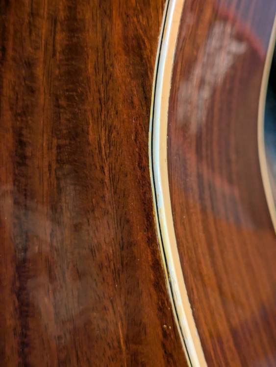

The binding on my Martin is coming loose on the bottom/back. I have thin super glue, is this typically what is used to re-attach the binding?
If I attempt myself, can I work a bit at a time or do I need to glue the entire loose part at one time?  Can finger pressure work to hold it in place until set or should I bind it with cloth strips?

The separation is from the shoulder down to the widest part of the lower bout. The narrow and wide binding have also separated from each other. Not for a novice, all things considered and the comments. It has spent a lot of time in the case the past year, in the house. Weird to see that much separation all at once. It is a 1987 model so must be age related.
I've done this repair too many times to count. It is not age related, it is Martin related. Their white and ivory bindings shrink, causing them to pull loose from the waist curves. I've seen it with imports and Nazareths, single and mult-plies, old ones and not so old ones. You'd think they would have changed the binding material by now.

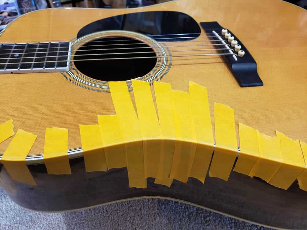

  • I use Titebond Red Label in a tiny needle-nosed bottle as my adhesive. There are binding cements that work better, as does CA, but EVERY adhesive I've tried, even sparingly, creates a squeeze-out mess. The trick here is to use a WATER SOLUBLE glue whose leftover residues can easily be cleaned with a wet cloth during the glue up as it squeezes out, and then after the glue up is cured. If you use the cement or the super glue, you run risk of messing up your clearcoat, requiring a wetsand and buffing and if really bad some refin work. I cannot emphasize this enough ... the DIYer should use a water soluble glue.
  • Prior to glue up, clean up the exposed binding channel with a little folded wedge of 400 grit sandpaper to remove any old glue crust, followed by cotton swabs dipped in VM&P naphtha.
  • Line your bench or table with a few dozen pre-torn pieces of tape, more than you think you will need. You will not be able to tear tape when you try to feed the binding into the channel gluing as you go.
  • Use a heat gun or a hairdryer to soften the binding immediately before glue up so you can GENTLY stretch it back into the binding channel. Don't overheat the binding!
  • Use a lot of masking tape to hold the binding in place and let it sit a few days to make sure it's fully cured.
  • When fully dry, GENTLY SLOWLY DELICATELY remove the tape, so you don't accidentally pull up clearcoat with the tape. Delicately scrape off any squeeze-out boogers with a fingernail or the edge of a credit card. Remove any glue film with a warm, damp rag. Go slow and let the damp rag do the work.
