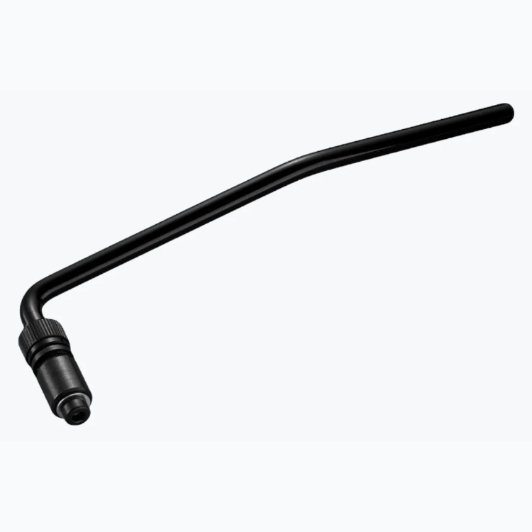

draelyc Posted May 26, 2025 Author Posted May 26, 2025 Huzzah! Got the truss rod to move on my own! Had to keep tinkering with it b/c of my CDO*. Guess it was just old and ornery, lol. I still have no idea what trem arm to get for the Schaller Floyd bridge — a quick net search yielded way too many options for my ignorant self to figure out. But since the truss rod is working, now it looks like I will be able to set it up to my specs, and that’s a huge, uh, well, relief. Pun apologized for. 😬 *CDO is the exact same disorder as OCD, except the letters are in proper alphabetical order as God intended. 😎

Carl.B Posted May 27, 2025 Posted May 27, 2025 19 hours ago, draelyc said: I still have no idea what trem arm to get for the Schaller Floyd bridge — a quick net search yielded way too many options for my ignorant self to figure out. Check with a pawn shop, MusicGoRound or local music shop. It's like they have all these unwanted trem arm's, and cases that people don't want for their guitars. I have bought a few term arm's from MusicGoRound they had a rather large box of them hidden behind the counter.
RobB Posted May 27, 2025 Posted May 27, 2025 21 hours ago, draelyc said: I still have no idea what trem arm to get for the Schaller Floyd bridge — a quick net search yielded way too many options for my ignorant self to figure out. Get one with the threaded collar. They work with OFR and Schaller versions.
draelyc Posted May 27, 2025 Author Posted May 27, 2025 33 minutes ago, RobB said: Get one with the threaded collar. They work with OFR and Schaller versions. Much appreciated — having a pic to go by is a huge help … thanks!
scottcald Posted May 27, 2025 Posted May 27, 2025 I have a Centaura exactly like that one. Great guitar. Personally, I prefer the push in arm. The screw on ones don't stay put for me. https://www.floydrose.com/products/frtapi?_pos=1&_psq=push+in&_ss=e&_v=1.0 They're available on Amazon too.
RobB Posted May 27, 2025 Posted May 27, 2025 8 minutes ago, scottcald said: I have a Centaura exactly like that one. Great guitar. Personally, I prefer the push in arm. The screw on ones don't stay put for me. https://www.floydrose.com/products/frtapi?_pos=1&_psq=push+in&_ss=e&_v=1.0 They're available on Amazon too. Scott beat me to the punch. I've installed the push-in arms on an OFR NFT and original and am never going back to collared arms. No slop at all, even when hanging loose. Easy to install, too. RobB sez, "check it out."

draelyc Posted May 28, 2025 Author Posted May 28, 2025 7 hours ago, RobB said: Scott beat me to the punch. I've installed the push-in arms on an OFR NFT and original and am never going back to collared arms. No slop at all, even when hanging loose. Easy to install, too. RobB sez, "check it out." Thanks, y’all! I would very much prefer a push in arm — would that fit with the bridge that’s on the guitar? When y’all say “easy to install,” I have to wonder how, um, subjective that is, lol!!😂

RobB Posted May 28, 2025 Posted May 28, 2025 21 minutes ago, draelyc said: Thanks, y’all! I would very much prefer a push in arm — would that fit with the bridge that’s on the guitar? When y’all say “easy to install,” I have to wonder how, um, subjective that is, lol!!😂 Remove the original housing (Allen wrench). Use a 12mm box or small crescent wrench for the new install. Remove the snap-in bar from the housing. Insert new housing into bridge plate. Screw-in 12mm nut below the bridge plate, making sure to keep the top housing’s bar-tensioning Allen screw facing rearwards. Tighten nut. You’re done.
draelyc Posted May 28, 2025 Author Posted May 28, 2025 14 hours ago, RobB said: Remove the original housing (Allen wrench). Use a 12mm box or small crescent wrench for the new install. Remove the snap-in bar from the housing. Insert new housing into bridge plate. Screw-in 12mm nut below the bridge plate, making sure to keep the top housing’s bar-tensioning Allen screw facing rearwards. Tighten nut. You’re done. It’s does look pretty simple on paper. But the cavity on the back of the Centaura t let me access the backside of that socket without taking the bridge all the way off the guitar. Not that that’s not doable; it’s just a hassle, gnome sane? Oh, and the fact that I’m pretty lazy… 😬

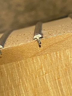

draelyc Posted June 2, 2025 Author Posted June 2, 2025 Welp, I’m pretty disappointed, y’all. Looks like this one’s going back to Guitar Center. Ive been struggling to get the thing set up and playing — and more importantly *feeling* — right. To be fair, I am VERY persnickety about my setups. I have a certain set of string gauges, a certain string height, a certain neck relief, &c., that I pretty much have to have in order to feel connected with a guitar. This one just wasn’t falling into place, no matter what I tried. And tonight, I finally sussed out why. There’s damage at the 18th fret. I’ll try to post some pix. I don’t know if it’s fixable — probably is — but I don’t want to have to do a repair on a guitar I just bought from a vendor that was supposed to have inspected the thing thoroughly beforehand. Gnome sane? But man, a New Hamer Day is pretty rare for me. I’m am disappoint!

Cboss Posted June 2, 2025 Posted June 2, 2025 Something you could try, I have had to do this on import fretboards; take a wooden dowel, put it right at the spot where the Fret is lifted and give it a light bang with a hammer.. this has worked many many times for me
draelyc Posted June 2, 2025 Author Posted June 2, 2025 1 hour ago, Cboss said: Something you could try, I have had to do this on import fretboards; take a wooden dowel, put it right at the spot where the Fret is lifted and give it a light bang with a hammer.. this has worked many many times for me I thought about that, actually, but it looks to me like the wood of the fingerboard is splintered there a little bit, and I’ve no idea what to do about that…

burningyen Posted June 2, 2025 Posted June 2, 2025 19 hours ago, draelyc said: Ouch, that sucks. Definitely fixable, but it won't be free or invisible.
