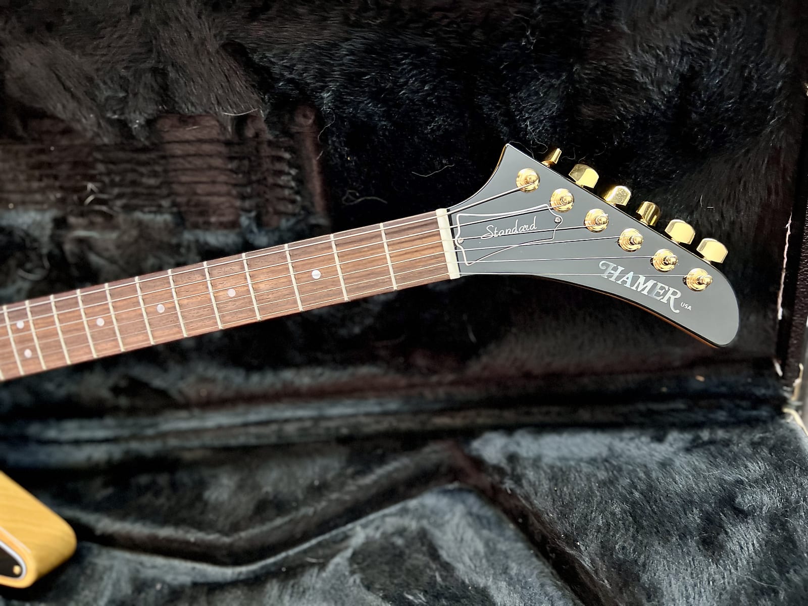

zorrow Posted July 1, 2025 Posted July 1, 2025 A close friend of mine kept one my Standards for a while, so he adjusted it and tuned it to his tastes. Now, this is new to me: The high E, the B and the G strings are now wound “the wrong way”, so the machine heads turn clockwise to rise the pitch, and counterclockwise to lower it. So weird! Of course, I have seen and played many guitars featuring six-in-line headstocks, but this is the first time I see the strings configured this way. 🤷🏻♂️ Is this something some of you guys also do? 1 1 Quote
DaveH Posted July 1, 2025 Posted July 1, 2025 No, but I get why he did it. Or at least what he was trying to accomplish. 2 1 Quote
zorrow Posted July 1, 2025 Author Posted July 1, 2025 1 minute ago, DaveH said: No, but I get why he did it. Or at least what he was trying to accomplish. I haven’t asked him yet, because I just noticed, but I think he was trying to keep the high E string inside the area of the headstock. But from a functional standpoint, I don’t know if there’s any other reason. Why do you think he did so? Quote
Dave Scepter Posted July 1, 2025 Posted July 1, 2025 He's keeping the strings as straight "over the nut" as possible 10 1 Quote
kizanski Posted July 2, 2025 Posted July 2, 2025 (edited) 1 hour ago, Dave Scepter said: He's keeping the strings as straight "over the nut" as possible This. Seen it done many times. Edited July 2, 2025 by kizanski 1 1 Quote
zorrow Posted July 2, 2025 Author Posted July 2, 2025 2 hours ago, Dave Scepter said: He's keeping the strings as straight "over the nut" as possible WOW! That’s what he said —asked him few minutes ago. This is totally new to me. 🤷🏻♂️ 1 Quote
soli'd Posted July 2, 2025 Posted July 2, 2025 I thought something was going to be jacked up, instead, we learned something today. 3 Quote

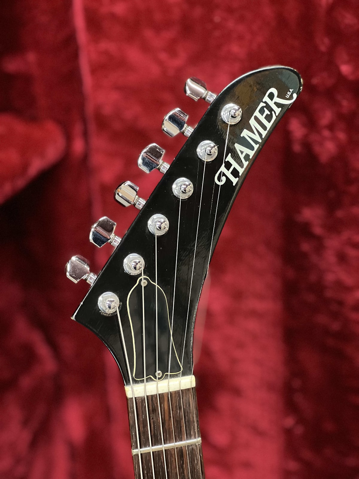

Jim85IROC Posted July 2, 2025 Posted July 2, 2025 what's interesting to me is that the nut appears to be cut with straight nut slots. That also looks like an off the shelf pre-cut nut with very deep nut slots. I'm no USA Standard expert, but what I've generally seen in the ones that I've paid attention to in the past was a nut that was specifically cut with angled slots to deal with the angle of the string pull. Here's a 4 digit Standard on Reverb right now that has the nut cut with angled slots: Here's an 05 that appears to be cut the same way. This pic is a bit washed out so it's hard to tell, but that's how it looks: 2 Quote
kizanski Posted July 2, 2025 Posted July 2, 2025 5 minutes ago, Jim85IROC said: what's interesting to me is that the nut appears to be cut with straight nut slots. That also looks like an off the shelf pre-cut nut with very deep nut slots. I'm no USA Standard expert, but what I've generally seen in the ones that I've paid attention to in the past was a nut that was specifically cut with angled slots to deal with the angle of the string pull. Here's a 4 digit Standard on Reverb right now that has the nut cut with angled slots: Here's an 05 that appears to be cut the same way. This pic is a bit washed out so it's hard to tell, but that's how it looks: Nut slots aside, look how much better the 4-digit headstock looks. And if you notice, both guitars are strung up with the plain strings "backwards." Even the D string on the 4-digit. 2 Quote
Jim85IROC Posted July 2, 2025 Posted July 2, 2025 1 minute ago, kizanski said: Nut slots aside, look how much better the 4-digit headstock looks. And if you notice, both guitars are strung up with the plain strings "backwards." Even the D string on the 4-digit. I do like the more slender early headstock. Nice catch on the unwound strings being backwards here too. For fun I checked some of the pics in my copy of "The Ultimate" and they seem to all be strung conventionally. Not only does it help with string angle, but I think it also looks better when they're strong "wrong". On my import Standard, the high E string is floating out there in space and not over the headstock. I think it looks stupid, but I also don't want to deal with backwards tuning on one guitar. 1 Quote
soli'd Posted July 2, 2025 Posted July 2, 2025 18 minutes ago, Jim85IROC said: what's interesting to me is that the nut appears to be cut with straight nut slots. That also looks like an off the shelf pre-cut nut with very deep nut slots. I'm no USA Standard expert, but what I've generally seen in the ones that I've paid attention to in the past was a nut that was specifically cut with angled slots to deal with the angle of the string pull. Here's a 4 digit Standard on Reverb right now that has the nut cut with angled slots: Here's an 05 that appears to be cut the same way. This pic is a bit washed out so it's hard to tell, but that's how it looks: Weirder still is that someone apparently photoshopped out the offending high-E string overhanging the void in the 4-digit pic. 6 Quote
kizanski Posted July 2, 2025 Posted July 2, 2025 (edited) 7 minutes ago, Jim85IROC said: I think it looks stupid, but I also don't want to deal with backwards tuning on one guitar. I agree. That's why I never did it either. 1 minute ago, soli'd said: Weirder still is that someone apparently photoshopped out the offending high-E string overhanging the void in the 4-digit pic. ...and poorly. Edited July 2, 2025 by kizanski 4 Quote

zorrow Posted July 3, 2025 Author Posted July 3, 2025 5 hours ago, Jim85IROC said: what's interesting to me is that the nut appears to be cut with straight nut slots. That also looks like an off the shelf pre-cut nut with very deep nut slots. I'm no USA Standard expert, but what I've generally seen in the ones that I've paid attention to in the past was a nut that was specifically cut with angled slots to deal with the angle of the string pull. Here's a 4 digit Standard on Reverb right now that has the nut cut with angled slots: Here's an 05 that appears to be cut the same way. This pic is a bit washed out so it's hard to tell, but that's how it looks: I find it chaotic having some strings wound differently. I care much more about consistency and functionality than about how the guitar looks. By the way, I love both headstocks, but I like the chunkier headstock of the more recent Standards better. It’s more Hamer, less Gibson, and looks sturdier to me. 🤷🏻♂️ 3 Quote

Dave Scepter Posted July 3, 2025 Posted July 3, 2025 (edited) 52 minutes ago, zorrow said: I find it chaotic having some strings wound differently. I care much more about consistency and functionality than about how the guitar looks. Having those strings straight across the nut has absolutely NOTHING to do with looks 🙄 Edited July 3, 2025 by Dave Scepter 2 1 Quote
zorrow Posted July 3, 2025 Author Posted July 3, 2025 15 hours ago, Dave Scepter said: Having those strings straight across the nut has absolutely NOTHING to do with looks 🙄 I do get that. 🤷🏻♂️ 1 Quote
