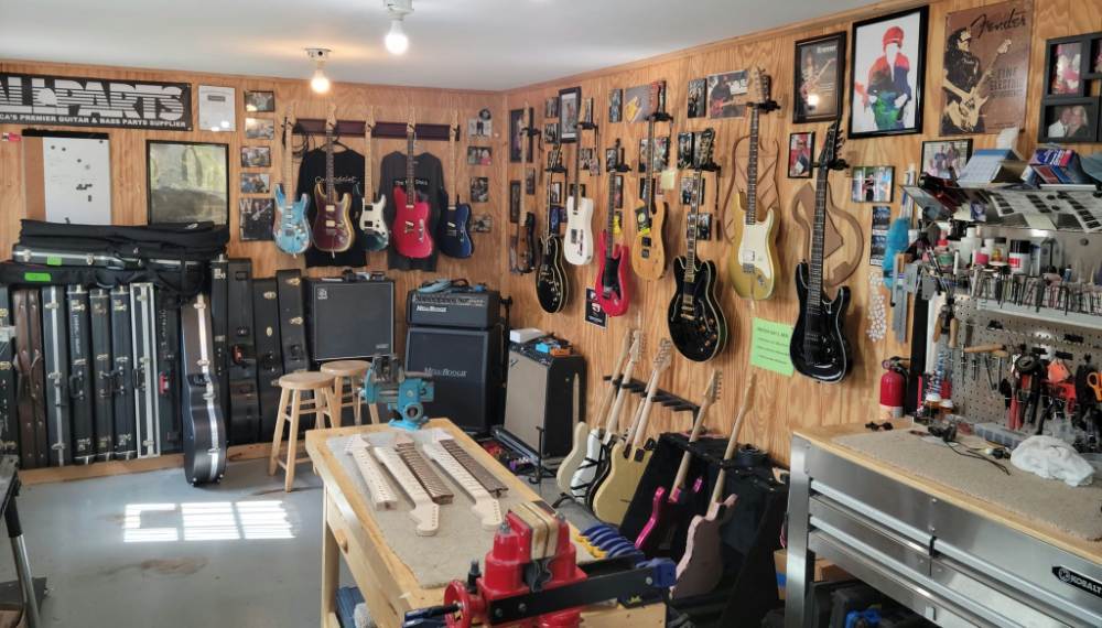

I have two of String Swing's version in my shop. I've hung tens of thousands of dollars in clients' and my own guitars with zero problems whatsoever (knock on rosewood). Not only incredible sturdiness but also zero issues with hook padding/foam reacting negatively with finishes. BE SURE to research that aspect of the rack on Amazon. You can always beef up the wall mount scheme as you see fit, it's the padding where you really need to do your homework.

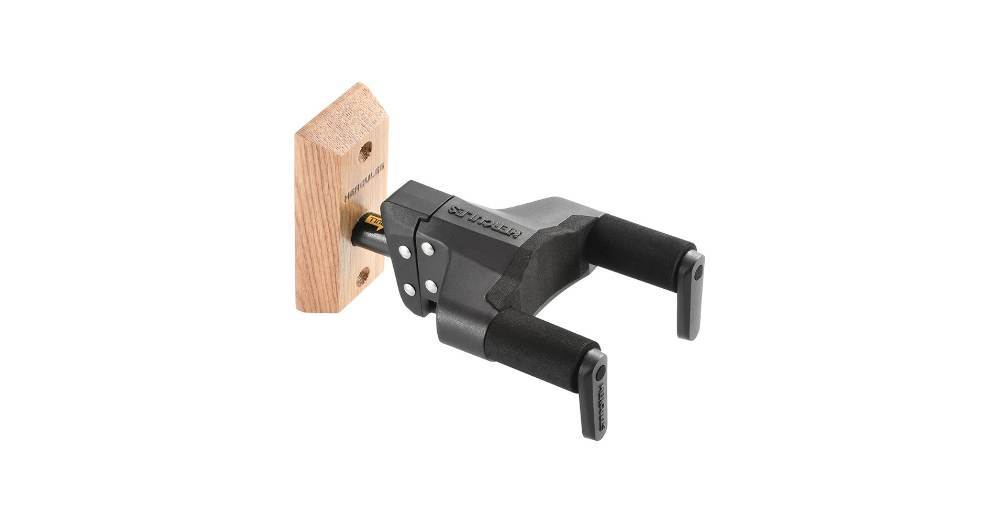

For single unit mounting hooks, I've had the Hercules GSP series wall hooks in the shop for 10 years now. They are the type that the instrument's weight closes the ears of the hook, and it is going NOWHERE.  $20 apiece from your mouse-click storefront of choice, slightly cheaper bought in bulk, and absolutely zero issues.

I like the Hercules cradle, but if I used individual Hercules hangers I would end up mounting them to a board so that I could locate the fasteners on wall studs. The String Swing skips that step. They're 48" long for a five-spot unit. I think I might buy a couple of those.

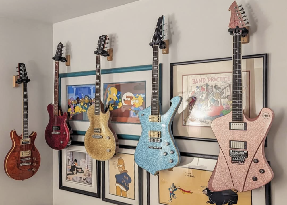

Like Jeff I also have several of the Hercules and like them a lot. The 4 pictures are screwed into a header so I didn't have to worry about stud spacing. There will be three more going in below those before too long, will be painting a 1x4 poplar board from Lowe's to match the wall and screwing that into studs and screwing the hangers into the board, I don't trust drywall anchors.
I like those animation cels, especially the one from Bully for Bugs (what a nin-cow-poop!).  My sister started collecting them years ago when you could get them for nothing.  She must have at least 50, all from Looney Tunes or Disney, except for one from the Grinch.  I have one seri-cel of the Beatles from Yellow Submarine.

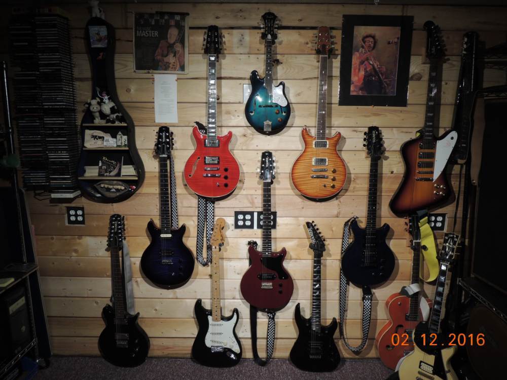

I snagged Kiz's Hercules hangers (the best out there) when he downsized and swapped them for the cheapos seen here:
I screwed pallet boards to the studs and was free to place the guitars however I wanted. The unexpected benefit is the humidity stays really stable. And if you saw the rest of this blown-up room, you'd think this looks great.
And never - I mean NEVER - use fucking drywall anchors. Well, unless you like broken gear.
  • Like 7
