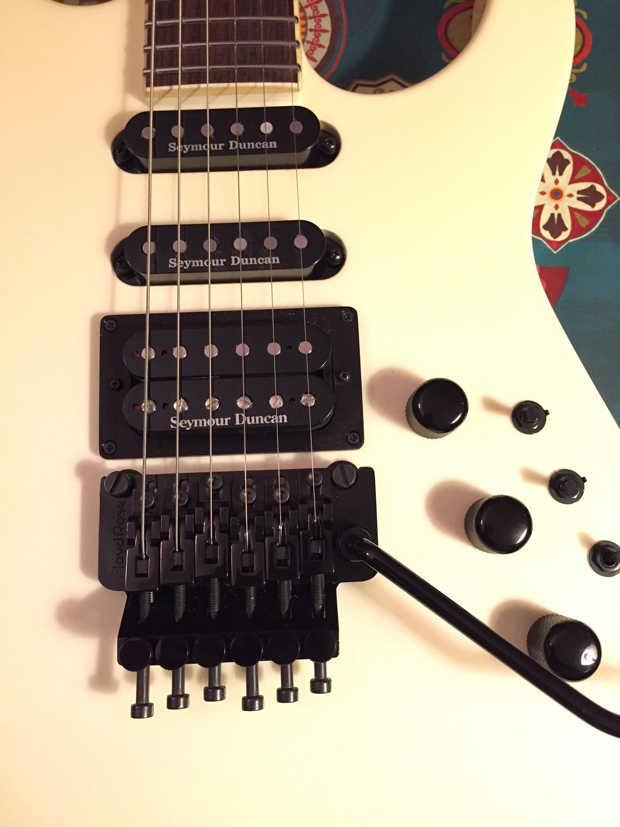

slipstream Posted April 7, 2016 Posted April 7, 2016 I've had mine for a while and added stainless frets, a Floyd and Duncan RTM. Crank it through an old Boogie Mark III and you have serious neighbor issues!

slipstream Posted April 7, 2016 Posted April 7, 2016 I gutted mine for Duncans and an EMG A/B switch, much better all around, A Kahler nut finished the job.
