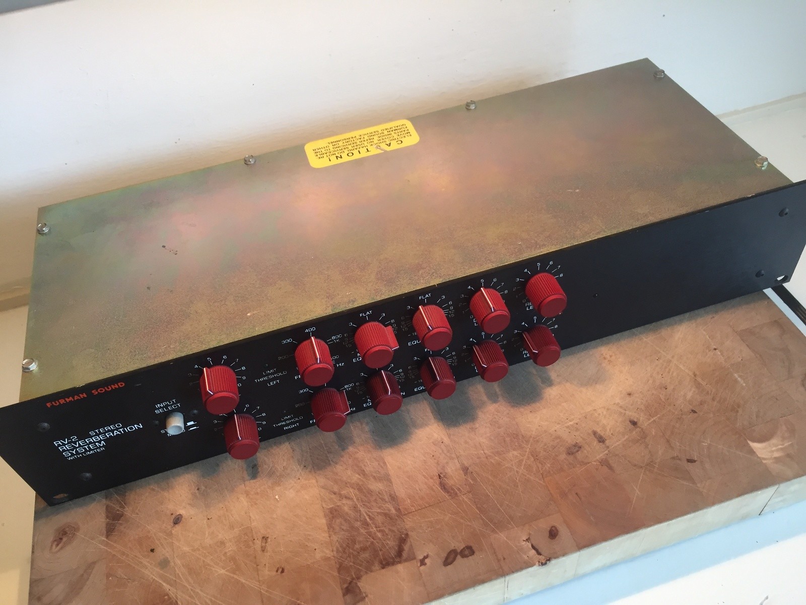

tomteriffic Posted July 28, 2016 Posted July 28, 2016 Expanding just a little, a shorter two-spring tank will yield a less diffuse (thinner) reverb due to there being fewer springs, and less depth, due to the shorter time it takes a wave to traverse the spring. That's all else being equal, of course. Spring tension and circuitry fore and aft of the spring play into it too, to some degree. I'm not 100% sure of it, but it may have been Hammond that came up with the spring reverb, or at least brought it to commercial success. Their "spring in a bag", built into their non-Leslie speakers could put your B-3 into any of Europes Medieval cathedrals. A five (or so) foot long spring hanging in a vinyl bag from the top of the cabinet inside. A wonder. Fed back like crazy too. For us mere mortals, for my money, the king-hell spring reverb is the Furman RV-2. Six springs per side in stereo, 12 in mono, all different lengths and tensions. Input limiters to minimize "boing", EQ on the returns to suit your needs, etc.

Bloozguy Posted July 28, 2016 Posted July 28, 2016 1 hour ago, tomteriffic said: Expanding just a little, a shorter two-spring tank will yield a less diffuse (thinner) reverb due to there being fewer springs, and less depth, due to the shorter time it takes a wave to traverse the spring. That's all else being equal, of course. Spring tension and circuitry fore and aft of the spring play into it too, to some degree. I'm not 100% sure of it, but it may have been Hammond that came up with the spring reverb, or at least brought it to commercial success. Their "spring in a bag", built into their non-Leslie speakers could put your B-3 into any of Europes Medieval cathedrals. A five (or so) foot long spring hanging in a vinyl bag from the top of the cabinet inside. A wonder. Fed back like crazy too. For us mere mortals, for my money, the king-hell spring reverb is the Furman RV-2. Six springs per side in stereo, 12 in mono, all different lengths and tensions. Input limiters to minimize "boing", EQ on the returns to suit your needs, etc. Back in my studio days we had an AKG BX 20 spring reverb and an EMT 140 plate reverb. For their size and price the little Furmans were darn near as good as the monster AKG. Of course these days you can buy BX 20 and EMT 140 plug ins that sound killer.
tomteriffic Posted July 29, 2016 Posted July 29, 2016 17 hours ago, Bloozguy said: Back in my studio days we had an AKG BX 20 spring reverb and an EMT 140 plate reverb. For their size and price the little Furmans were darn near as good as the monster AKG. Of course these days you can buy BX 20 and EMT 140 plug ins that sound killer. Oh yeah. We had 7 plates, 7 chambers and an AKG. But you weren't likely to take them on the road. I guess I was thinking more along those lines, guitar amps and such. Although during my touring sound days we used that Furman on a number of FOH things. This was all pretty much before affordable, good sounding digital came along, though.
