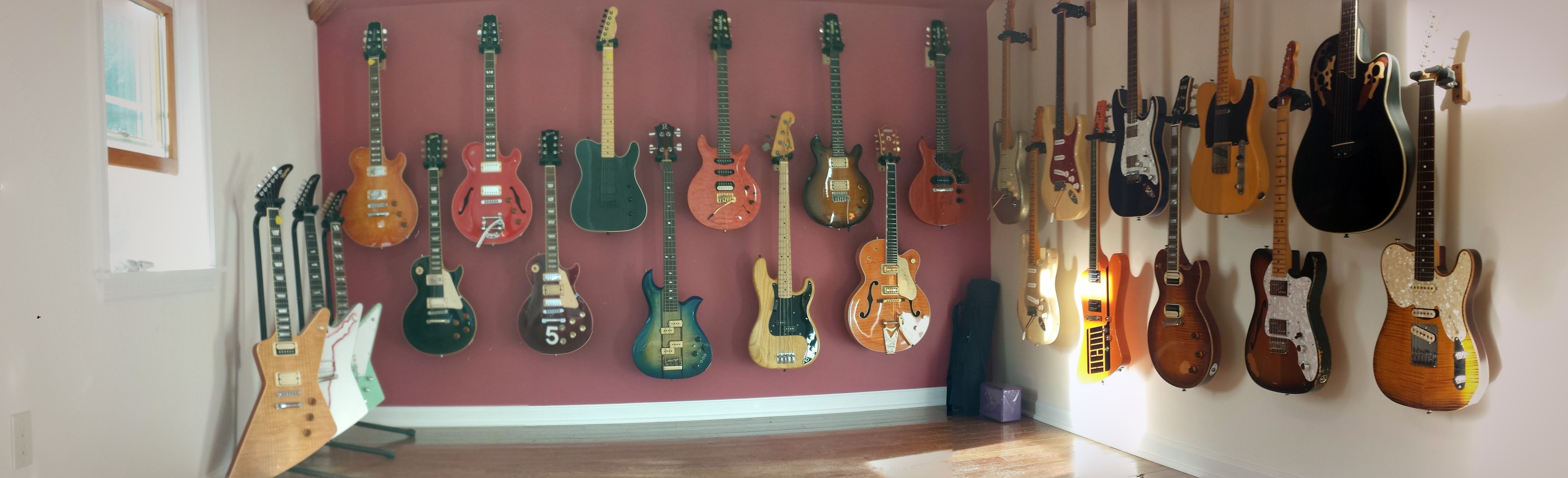

kizanski Posted April 13, 2017 Posted April 13, 2017 I spec'd 5/8" plywood on these walls when we built this room so I wouldn't be limited by stud location.
hamerhead Posted April 13, 2017 Posted April 13, 2017 Smart move, Kiz. My wall were already there, so the boards went on the outside: Re-purposed crate boards (which - in the real world - are just old pallets knocked apart and screwed to the wall). Unless the hanger breaks, the guitars ain't coming down. The surprise was how the wood stabilized the humidity in the room.
