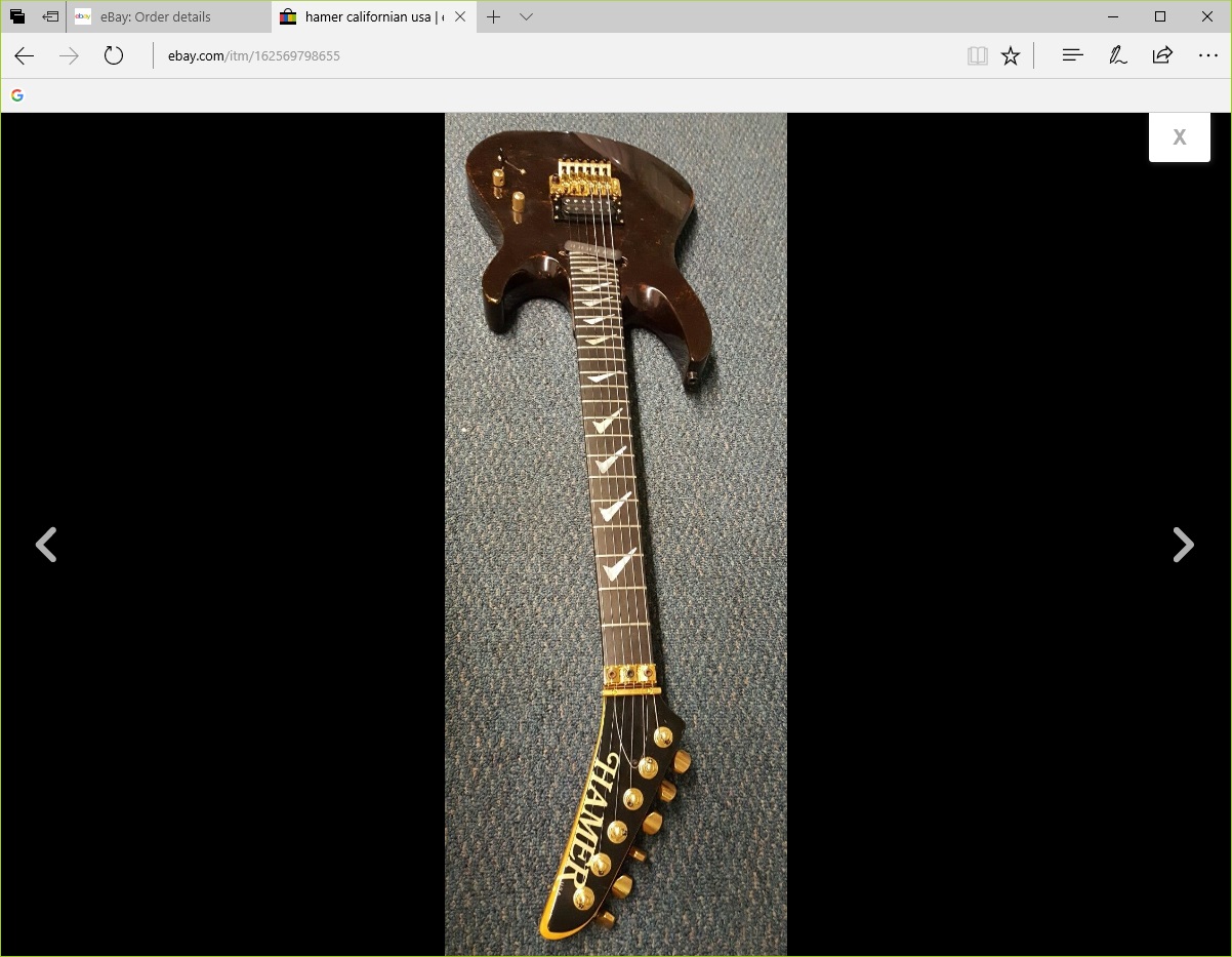

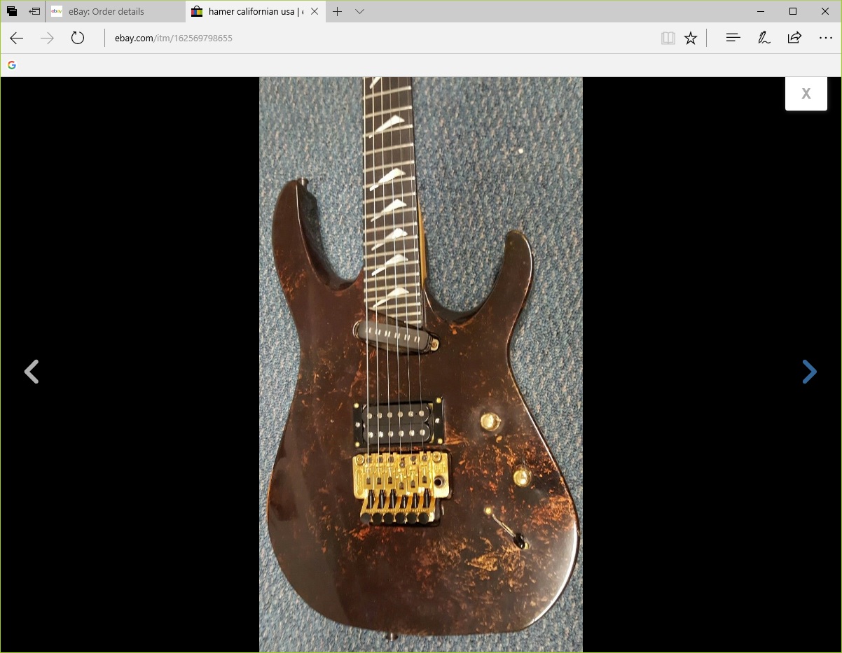

terrencerocks Posted July 4, 2017 Posted July 4, 2017 Strange thing, he replaced the FLoyd with one that says Gibson on it, still a Schaller, and he put a Tone Zone pickup on it.
Spadeace Posted July 4, 2017 Posted July 4, 2017 Not so strange, after all all those label branded ones were made by schaller (except the bc rich that was gotoh?)
terrencerocks Posted July 4, 2017 Author Posted July 4, 2017 I think I am going to put a triple A Matching Flame maple cap on it and have it be a Wicked Red color, Never liked this paint. My Last two were Red Sparkle. With the flame maple cap in will look like it has maple binding, It will look killer. Probably Replace the Tuners with New Sperzials and get a non-branded FloyRose. Neck is really Nice.
