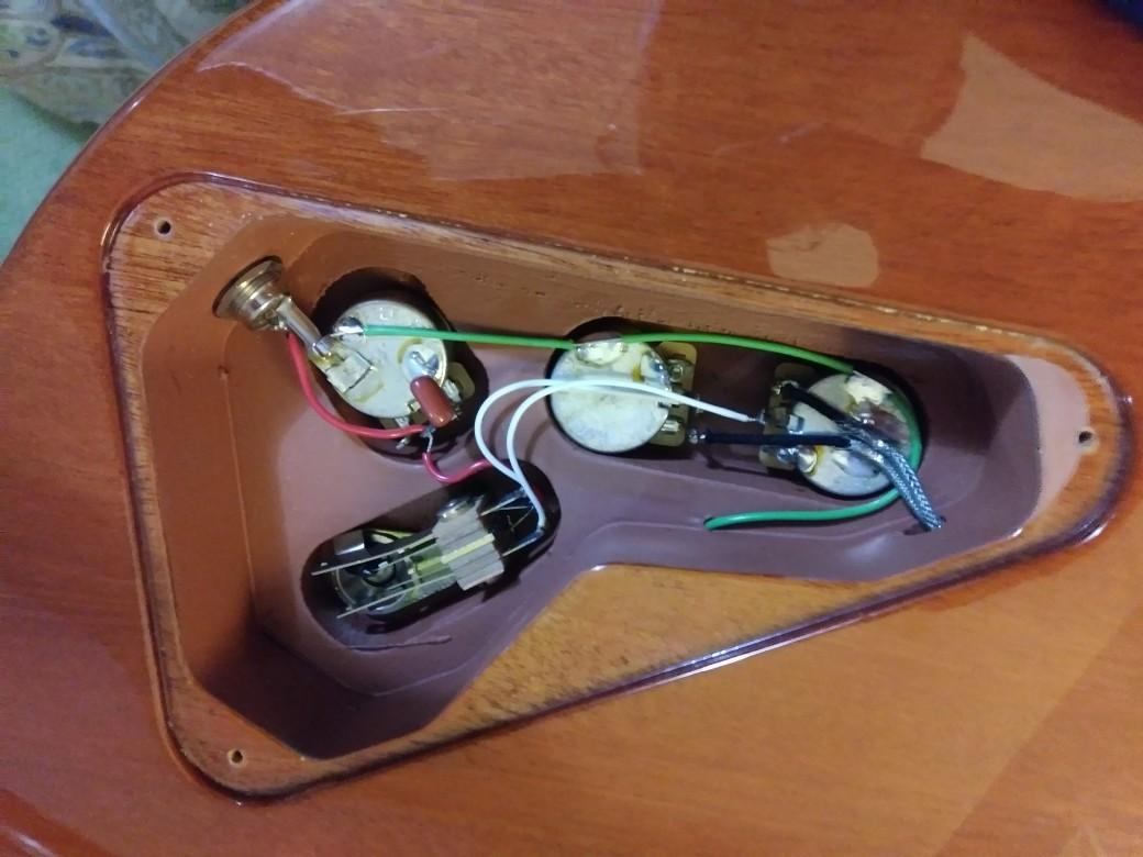

I'll let the pros answer this as there are so many variables to this question however, one of the most important things that I do is take pictures of the control cavity "before" and determine which leads are Hot and ground... Different pickup manufacturers often use different wire color conductors for hot, ground & coil conductors to tie together... once you determine that, the rest is pretty easy...6lGHyAs.png
Thanks. I have photos of the cavity and know which wire is the bridge and which is the neck PU. I’m an EE so that part is no problem. Black is the PU lead and braid is ground.
