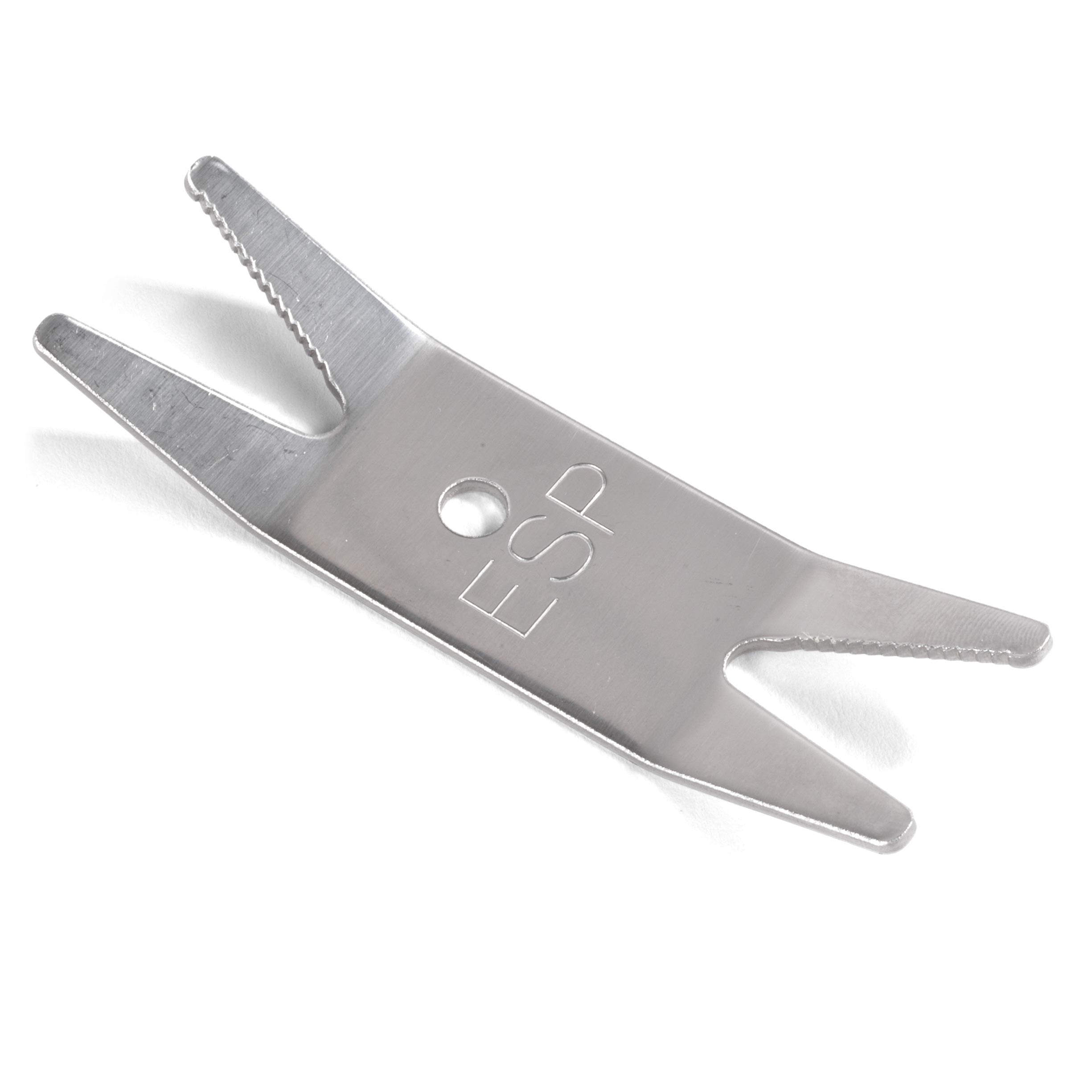

I have the SM handled tool to which Kiz referred, it works great. This is also a great tool for all knurled round and hex heads. Google "ESP Multi Spanner." $12-15 from a variety of sources.
ESP Multi Spanner - StewMac
